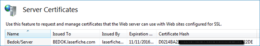

Step 1: Find the certificate hash for the certificate that is used in Forms website. You can get it from IIS manager, as shown in this picture.

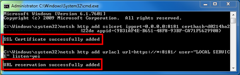

Step 2: Run the following commands, fill the certificate hash, fill #appid with a random GUID, and replace “LOCAL SERVICE” with your own local service account name.
  • netsh http add sslcert ipport=0.0.0.0:8181 certhash=#certhash appid={#appid}
  • netsh http add urlacl url=https://*:8181/ user="LOCAL SERVICE" listen=yes
 After you run the command, you should get success response as shown in this picture.
