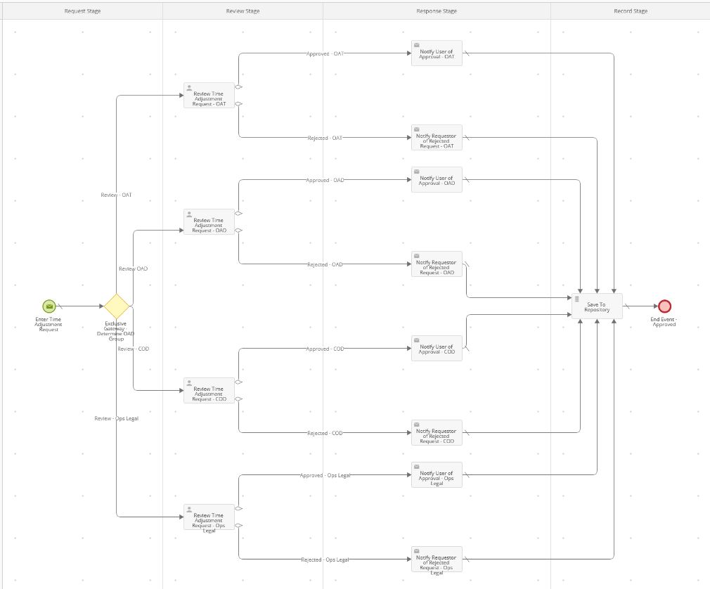

My Business Process keeps terminating, with the error message indicating that the gateway cannot be split to any subsequent branch.  Am I doing something wrong?  Please see the image of my business process (Forms 10).
It is being routed to four different user tasks in order to be assigned to different people based on the department selected on the starting form.  The process terminates after the manager approves or rejects, but it should be routed based on that action.

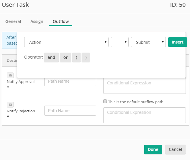

You should be able to remove most of your gateways and do the flow logic from within the tasks.   Use the outflow tab on the tasks for Approvals or Rejections.   These are under Process Variables -> Action.

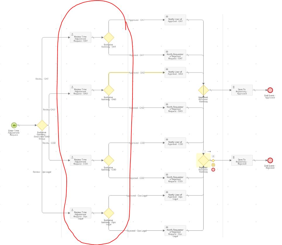

Thank you Andrew.  I removed most of the gateways and it still terminates. I wonder if I need to start over like I had to do with the form when I added an additional field to the starting form, and the variable wouldn't carry over to the subsequent forms.

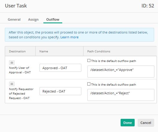

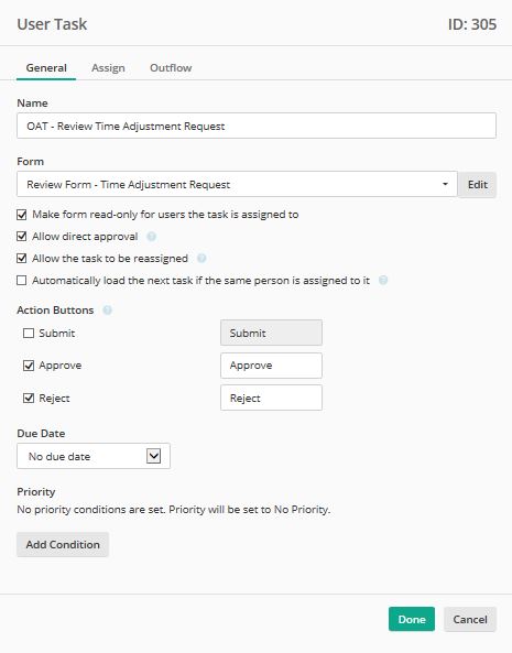

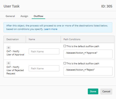

The process is flowing out of the gateway and getting assigned properly, but it is terminating after the assignee completes the user task, by selecting an action "Approve" or "Reject."  I don't get it, because I think I'm typing the conditions exactly as they appear on the action buttons.
