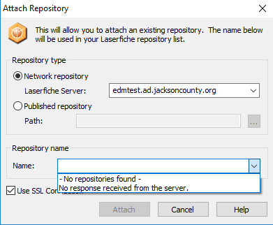

I have followed the instructions here: https://www.laserfiche.com/support/webhelp/Laserfiche/10/en-us/administration/Default.htm#../Subsystems/LFAdmin/Content/Using_SSL_TLS.htm
But when I attempt to connect with the client, I get the error "No Response Received from the Server [780]"
  • I have a certificate installed on the laserfiche server Certificates (Local Computer)\Personal\Certificates.
  • It was issued by a trusted root certification authority to the FQDN of my server.  That authority is also a trusted root certification authority on the client machine.
  • I specified the ssl port in HKLM\Software\Laserfiche\Engine\8.0\HttpServ\SSLPort
  • I ran netsh http add sslcert ipport=0.0.0.0:443 certhash=MYCERTHASH appid={00112233-4455-6677-8899-AABBCCDDEEFF}
  • I restarted the Laserfiche Server Service
  • When I attach the repository from the client I get "No Response Received from the Server"
I'm out of ideas troubleshooting this,
Thanks for any help!

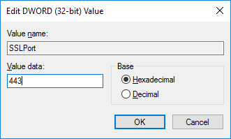

Running LFS in command line revealed the problem!
HttpServ: Attempting to listen on secure port 1091...
1091 is 443 in hexadecimal.  I changed the registry entry SSLPort to use Decimal Base, corrected the value back to 443, restarted and it works!

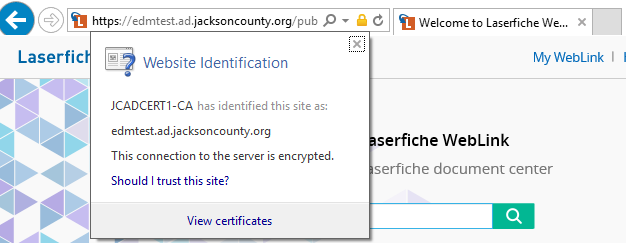

Just spit-ballin' here but have you tested SSL with LF by using IIS? If so, double checked all of your IIS settings...
  • IIS installed on your LF Repository server.
  • Bnd the certificate to Default Web Site: hostname=edmtest.ad.jacksoncounty.org,  Port=443, Type=HTTPS, IP Address=* (or what ever IP is appropriate for your environment)
  • I'd also set "Client certificates" to Ignore under the SSL Settings for the Default Web Site for testing.
replied on March 28, 2016
Ben, I bound the ssl certificate to the default website, with client certificates set to "Ignore"
I can view my site with https and everything looks good, details shown in the screenshot.
Thanks very much Michael, Miruna and Ben!
