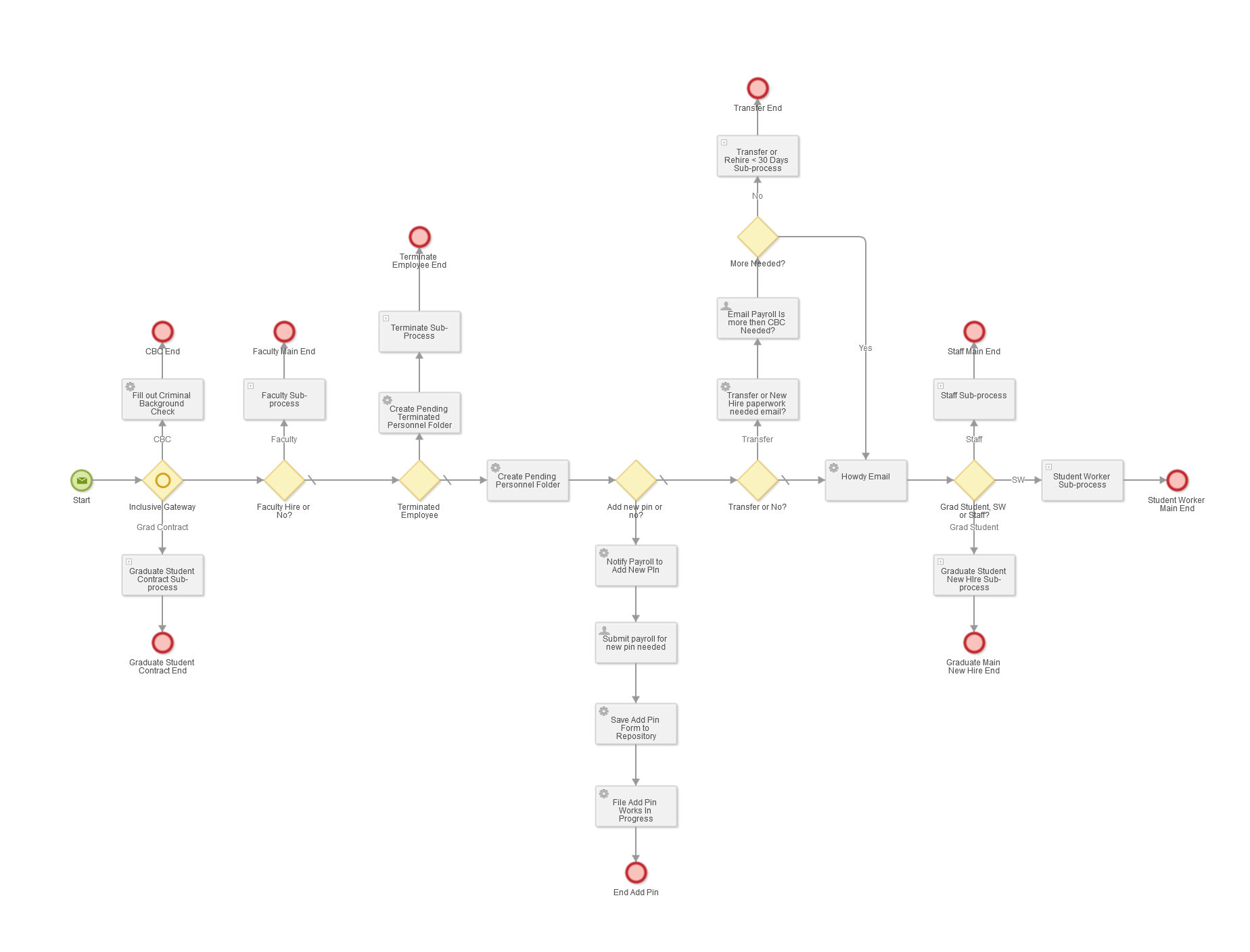

Attached is the main process, which divides off into several different sub-processes. A submitted form can only flow through at most 3 sub-processes. For the most part, the gateways just guide a submission to one of the sub-process (i.e. faculty hire, staff hire, student worker hire, transfer hire, graduate student hire, or termination). The reason for the different sub-proceses is because each type of hire requires different processes and hiring checklist.
