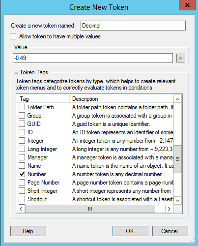

I tested the tokens and they were evaluated correctly for conditionals when set as a number or currency. Out of curiosity, what Token Tags were the tokens given?
replied on March 23, 2016

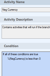

I went ahead and tested this further on workflow 10. Number token tag seems to work fine. Issue is with Currency token tag. Greater/less than check failure varies. Something weird going on.
Negative:
Leading zeros fails. -.39 succeeds whereas -0.39 fails.
Positive:
Leading zeros succeeds. .39 fails whereas 0.39 succeeds.

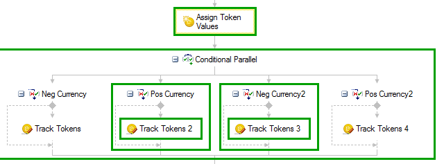

simple workflow test:

You are correct about currency. It turns out that currency does not have it's own way to compare two currency tokens, so it defaults to comparing them as strings.
Would you be able to use number tokens since those do have their own way to compare numbers?
