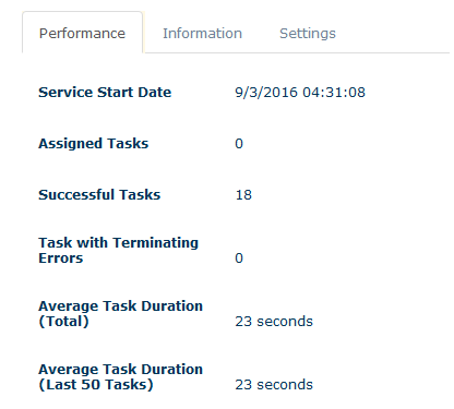

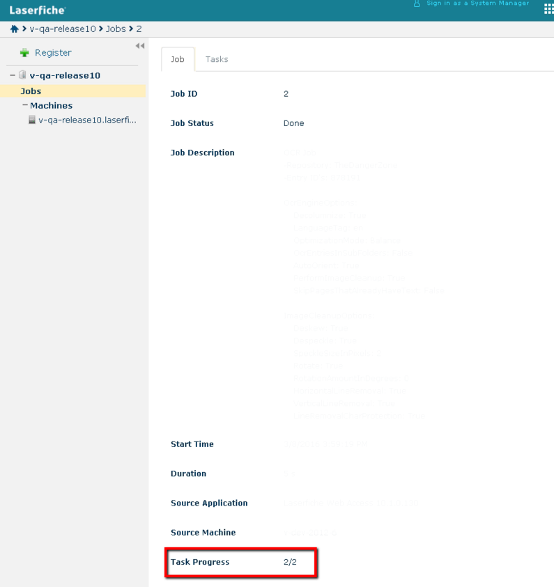

The DCC job should continue from where it left off. Completed tasks are not restarted.
If the job is taking quite some time, you could verify that it is making progress by checking if the number of completed tasks are rising in the Web Administration Console.
