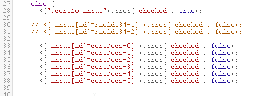

replied on April 27, 2016
So how do you determine Field134-1?
Here is my form in the designer
Here is my code, .certNO is working but the certDocs section is not.
