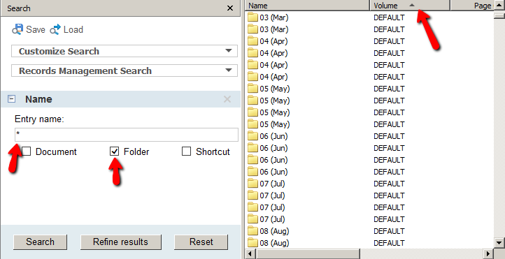

It's not exactly what you are looking for but one way is to perform a search for all folders, add the "Volume Name" column and sort by it:
3 0

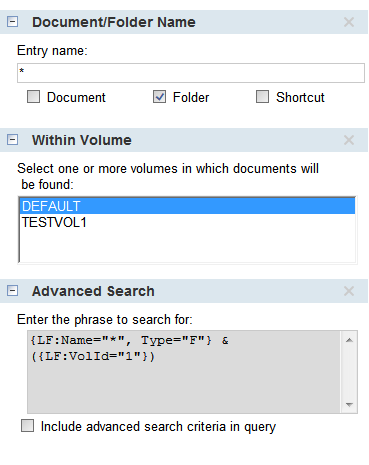

The syntax mentioned above would need to be customized to your particular volume ID. As Alex mentioned, the volume associated with a folder is actually the volume set as the default for the folder (since folders themselves do not reside within volumes)
However, this search is available through the UI, so no need to work with the search syntax unless you want to do something more complicated.
Here's an example of what the search would look like (with the search syntax pane open to show you the volume ID)

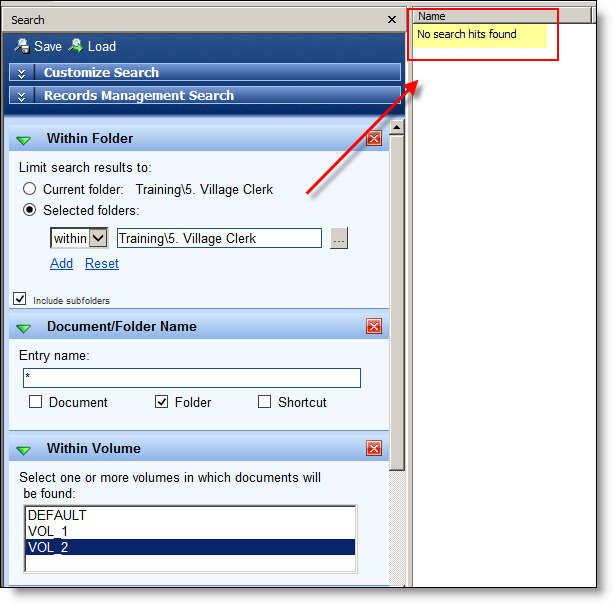

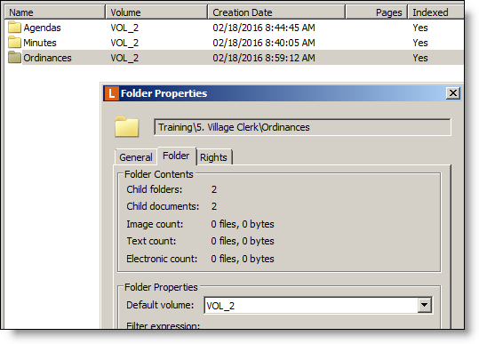

replied on March 11, 2016
Just an update... I've tested in LF 10 and the Search by volume gives correct search results. However, I've been able to reproduce the issue in LF 9.1.1 SP1, where the search reports no hits.
This functionality (the ability to search on the default volume assigned to a folder) was added in Laserfiche 10, so it is not present in 9.1.1 (as you noticed).
Sorry that was not mentioned in the earlier posts.
