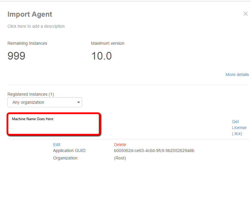

5. In case this is a Rio system, go to Laserfiche Directory Server Configuration page, go to Applications, select Import Agent and select the Instance associated to your server , then take a screen print (similar to the one below), if it is not a Rio system please skip this step.
