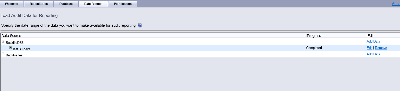

Thanks for the answers!  A follow up I got from our client is how can we point the current version of Audit Trail back towards the old data?
replied on March 10, 2016
When you upgraded to v10, did you manually change the location of the Audit Logs?  If not, both the old and the new data should be available in Audit Trail.  You just need to make sure that the Date Range (in the Audit Trail Config page) is set back far enough to include the v8 data (see screenshot).
