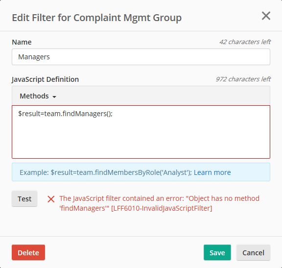

I've reviewed the help files/admin guide for creating JavaScript Filters Expressions and it indicates I should be able to use $result=team.findManagers() to assign a task to the team manager; however, I continue to get the following error message:
Can you help me understand what I'm doing wrong? Thank you!

That's a typo in the help file. The options currently supported are displayed in the "Methods" list.

"Manager" is just a role in the team, right? You can use $result=team.findMembersByRole('Manager');

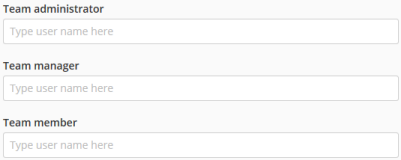

I'm sorry. I'm referring to the Team manager, as opposed to Team administrator or Team member.
If I'd like to escalate a task to the "Team manager," do I have to add that as a separate Role, as well?  Thanks for your help, Miruna!
