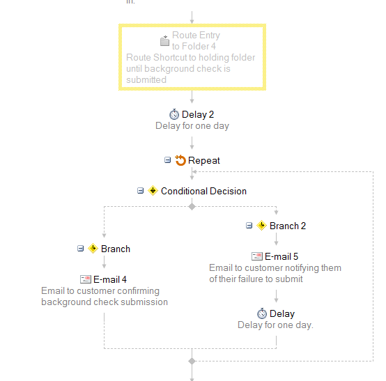

I am currently sending a shortcut to a folder and then having it removed from the folder once a decision is made. Is there a way to route an entry to a folder and wait there until a certain input is selected, but prior to the input being selected have the form move forward? I have attached an image of my current workflow for clarification.
replied on March 7, 2016
If I understand correctly, you want the Form to continue in the process, but also have a wait for the background check. If you want to keep something similar to your current design, you could just add the "Remove Shortcuts" activity inside the success branch, which will remove that shortcut to the form (and uncheck the box that deletes shortcuts inside the Route Entry to Folder).
If you wanted to have a completely separate waiting process, you could invoke another workflow here which would do the waiting and reminding for the background check submission. This would allow you to do more processing in the main workflow and then wait for the background check workflow to set a metadata value that tells the main workflow to continue going.

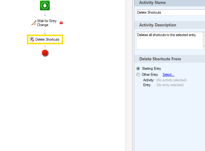

replied on March 7, 2016 Show version history
After your shortcut routing, you can use the Wait for Entry Change activity to detect the changes or for specific changes.  You can then use the Delete Shortcuts activity to remove the shortcut created earlier.
