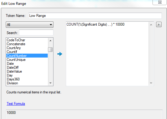

How can I get Workflow's token calculator to take a value and count how many digits are in that value, then create another number from the result?  Examples:
  • take value of 998050 and get a result of six digits, then take the number 1 and add six zeros to create the new token value of 1,000,000.
  • take value of 98050 and get a result of five digits, then take the number 1 and add five zeros to create the new token value of 100,000
  • take value of 8050 and get a result of four digits, then take the number 1 and add four zeros to create the new token value of 10,000
I can't seem to figure out how this CountNumber formula works or even if I'm on the right track here.

Thanks, Geoffrey.  It's not working as is.  I think part of it is because the brackets aren't quite right.  The token is %(Significant Digits) and yours shows it without the bracket between the % and Significant.  I've cut & pasted yours in exactly (no go), changed where the second opening bracket is (no go) and tried using the Power formula in my token calculator (no go).   Can you suggest what needs to be tweaked here to make mine work?
What is the Power formula trying to do in this scenario? I've figured out the LEN and that part is definitely a piece of the puzzle I want! (string length)
