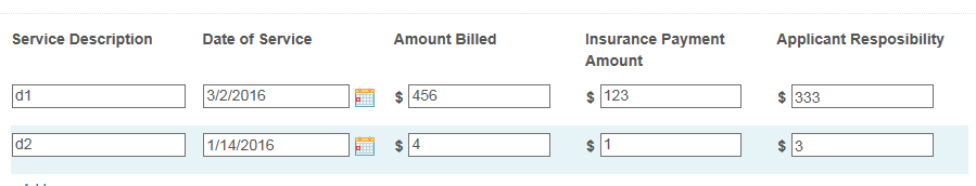

We have a form that has a table (dynamic size, not fixed),  When submitted, a workflow is run and at the end of the workflow we have a Set Business Process Variables.  We have some of the values being passed from the table into another table on the next form.  However, this does not seem to work when there are more than one row in the table.  So our Form on submit looks like this:

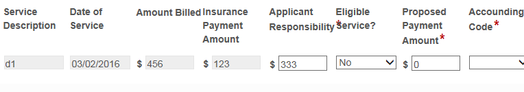

The workflow starts and the last step starts the verification form and that comes up as:
We don't have that second table line.  Is there anyway to do this?

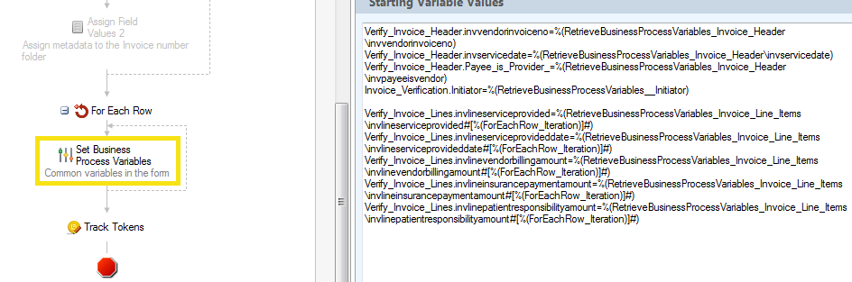

You need to use a workflow activity FOR EACH ROW on the initial submitted table.
replied on March 3, 2016 • Show version history
Tried that and it does not seem to work.  We used to have just one Set Business Process Variables.  I tried to add one in a For Each Row and set it to the retrieve line items.  I took the line item stuff out of the first Set Business and put it in the for each row.  Still no luck.
Also we did try a few other things.  It seems that you can only use one Set Business Process Variables as the above overwrote the below.  So we changed it to one activity.
So the one value fields are not being interated but the table lines are.  We have tried it a few different ways but nothing seems to do it.  With this setup though it does seem to pull over the last table row.  So if I do two rows in the table it pulls over the info from the second row not the first.

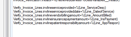

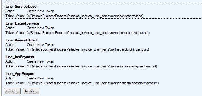

Thank you very much for the reply Miruna.  I think we have it setup right but it still only transfers one.  We created a multivalue token for each of the columns.
Then in the set variables we have
So it seems we are setting the next form table with the multivalue tokens.  Is this correct?  I am sure I am missing something as it still seems to just pull over one row.
replied on March 4, 2016
Why are you creating tokens to hold unmodified token values? Does it work if you use the token from Retrieve BP Values directly?

Turns out the user create the table that these were being passed to as a fixed number of rows and I didn't notice.  The fields were read-only so they could not change it (verification).  Didn't think to check that.  Changed the table accepting the values to be variable number and then it worked normally.  Side note - It seemed to work with the tokens as well as the normal Retrieve BP Values.  So it does work out of the box as expected, they just had the table things were transferring to was set to fixed rows.
