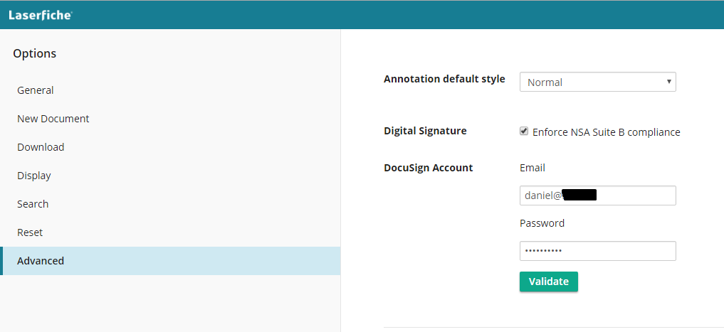

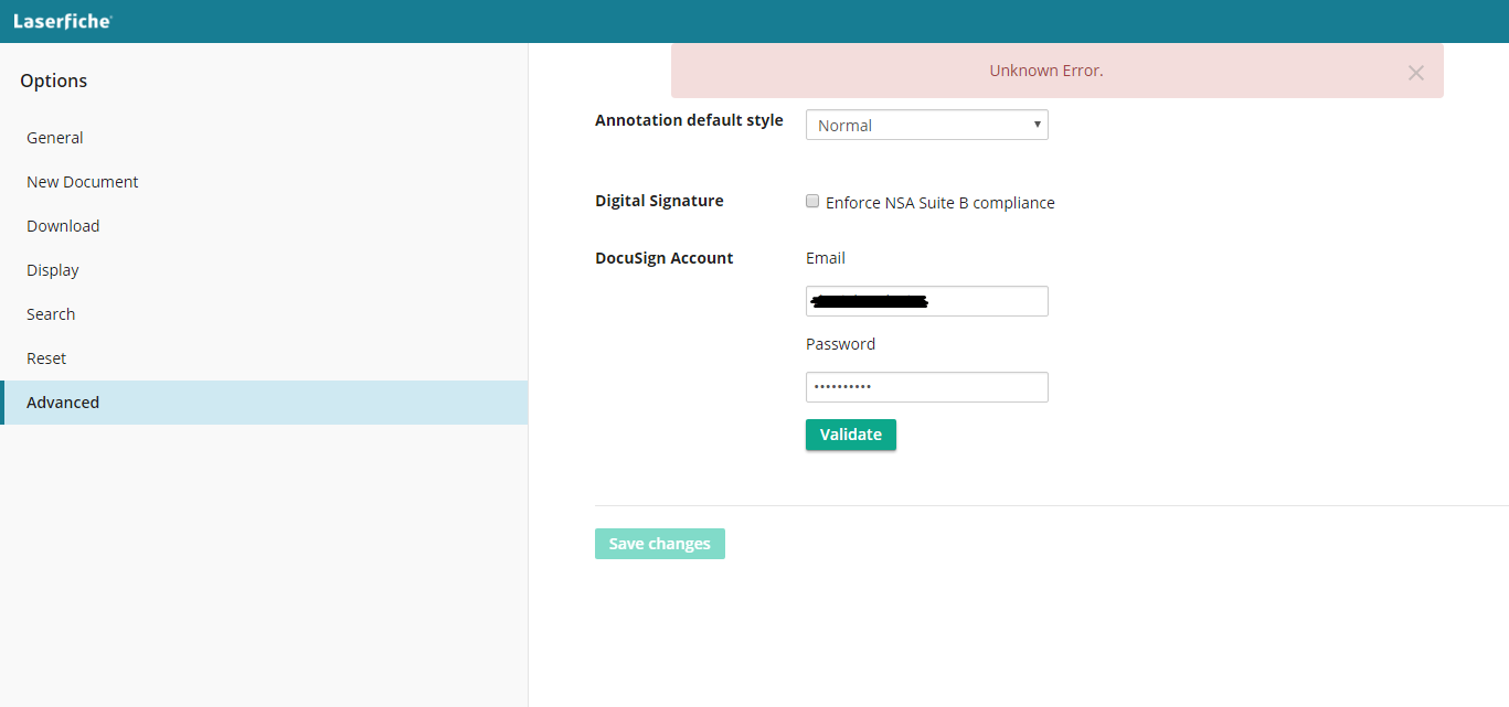

I'm currently having trouble configuring the Web Import Services and DocuSign Integration in Web Access 10. I've followed the instructions here step by step but continually get an "Unknown Error" message when validating my DocuSign account in Web Access Options
The only thing I can think of that might be causing this is that I'm using a DocuSign Developer account - does this service require a full/paid DocuSign account?

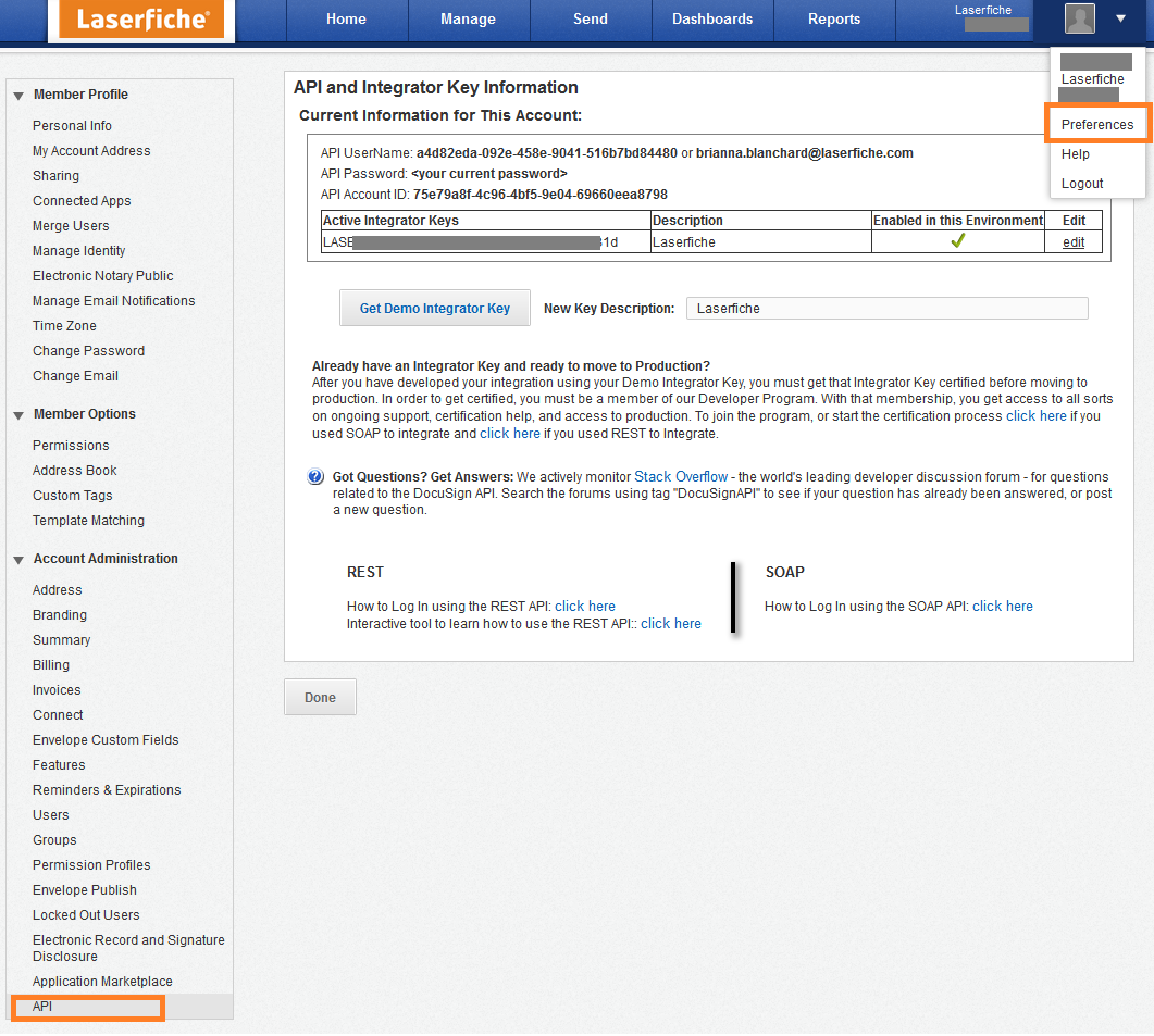

You can find your integrator key under Preferences > API:
If you don't have one yet, you can generate one using "Get Demo Integrator Key"

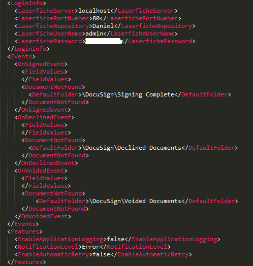

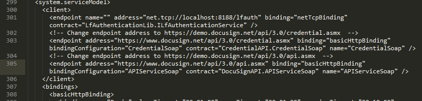

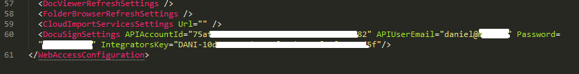

Thanks Brianna! This is exactly what I was looking for, however I'm still getting the same error so I guess I must have something else set wrong... Would you mind taking a quick look at these settings?
C:\Program Files\Laserfiche\Web Access\Web Files\web.config:
C:\Program Files\Laserfiche\Web Access\Web Files\Config\WebAccessConfig.xml:
C:\Program Files\Laserfiche\Web Import Services\DocuSignConnectService\Config\Config.xml

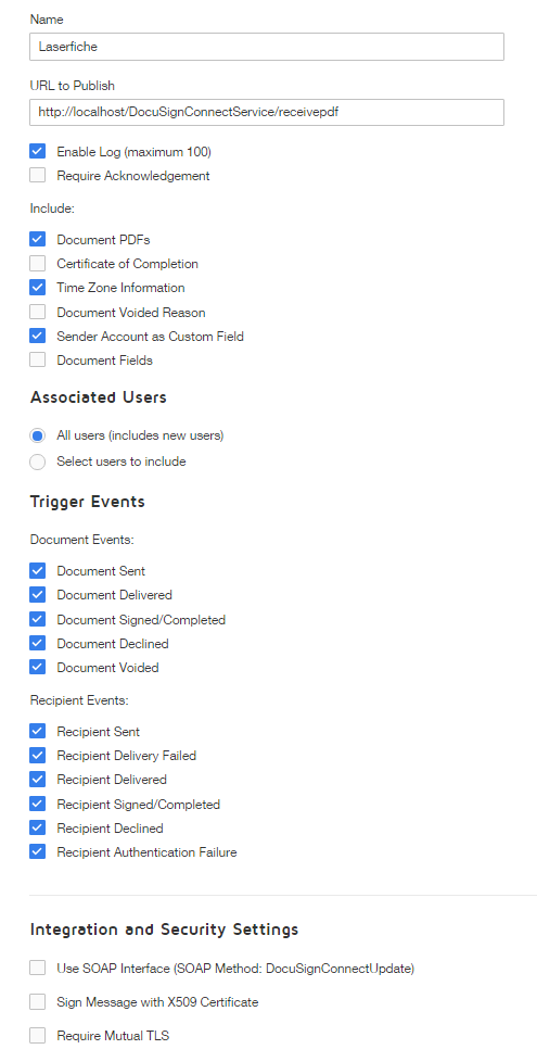

Options for DocuSign connect:
And options in Web Access:
I've not set up an X509 Certificate as shown towards the end of the documentation, but I have disabled this on the DocuSign Connect settings - would this still cause any issues?

Hi Dan,
The code snippet I posted for changing the demo information was just what it looked like in the file before the changes were made, with the comments that had the instructions. It didn't actually have the change made. I went ahead and edited the post so you can just copy+paste

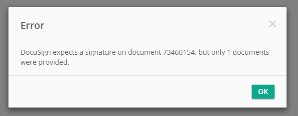

The issue occurs when attempting to send the document from Web Access to DocuSign when using templates created in the new UI.
I believe if you already have a template, it will work, but they can test this now by manually switching over to the new experience and trying to send a document out for signing. The error is something like "DocuSign expects a signature on document 47685633, but only 1 documents were provided. " and is shown in the Request Signature dialog.

I can't seem to get this working, even after following Brianna's edited instructions. I still get an "unknown error" in WA 10.2.1 options when validating the credentials, and the event viewer reports "No valid DocuSign API credentials found".
After creating an integrator key, do I need to do anything with it other than plugging it into Config.xml and changing the endpoints in web.config?
replied on October 3, 2017
OK, figured it out. My WebAccessConfig.xml had multiple DocuSignSettings blocks for some reason. Deleted the invalid one and restarted IIS. That did the trick.
