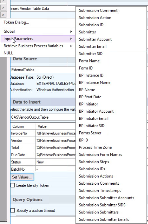

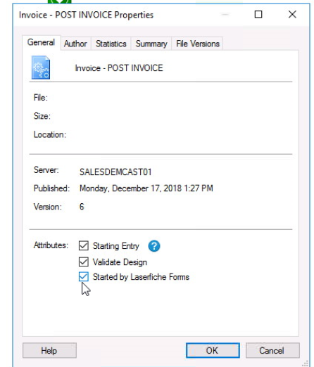

Hi Nicki,
You need to click on the Start of the workflow porcess,
on the properties right panel go to properties at the bottom and click on View worflow properties
and enable the check box "Started bt Laserfiche Forms"
this will give you access to a lot of input variable  parameters which are related to the forms instance that start this workflow

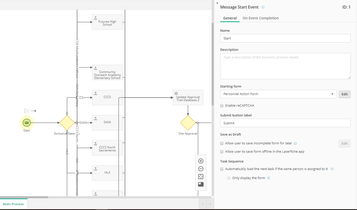

Nicki,
You are in Forms, not Workflow.
replied on November 13, 2019
There is another area? I have so far only been shown this to create workflows for forms
Workflow is a different Laserfiche product. The screenshots that Rene posted are from Workflow, not Forms.
replied on November 14, 2019
You need to invoke a workflow from forms and what I put as screen shot is from Laserfiche workflow
