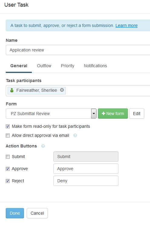

I have the exact same problem. This issue has stopped me dead in my tracks and unable to move forward with my forms process. I have the Approve and Reject buttons selected in my user task but only the submit button displays.
replied on March 21, 2016
Can you upload your process xml file or screenshots of user task configurations so we can further investigate into this issue?

replied on March 22, 2016
Rui,
I do not have any custom javascript in form. Please see user task config  below.

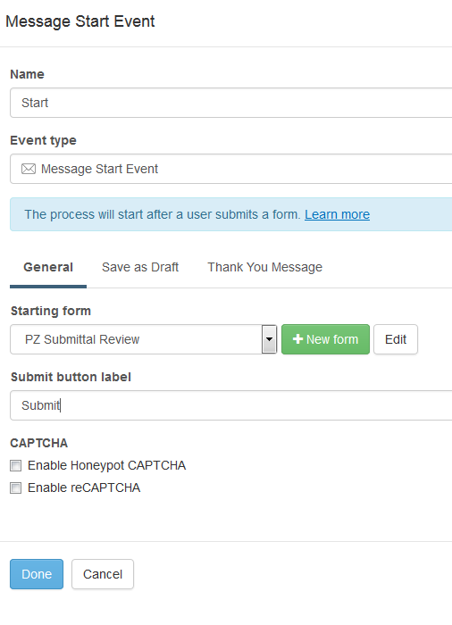

So I figured out the problem for my process.
My start event is a message start event which has a submit button label to actually start the process which i labeled 'Submit' instead of Start, so technically my user task was fine, it was displaying the same form which was really the start button. As soon as i changed it everything worked great.
Willie, Check your start event in your process modeler and ensure it doesn't have the label as Submit like mine below.
