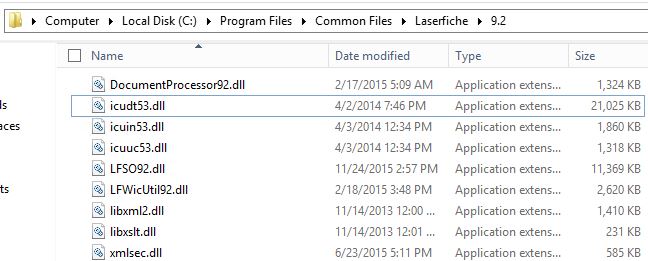

I have both SDK 10 and SDK 10 run time installed.  I just tried reinstalling 9.2 SDK again because I switched back to the 9.2 libraries to see if it was that.  Still the same issue.  Thanks for the input Michael.
replied on February 26, 2016 • Show version history

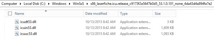

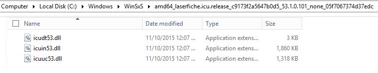

Can you check if the icudt53.dll file exists in the Program Files\Common Files\Laserfiche\9.2 directory? If your program is running as a 32-bit process check under Program Files (x86) instead.
In the C:\Windows\WinSxS directory there should be a subdirectory named amd64_laserfiche.icu.release_c9173f2a5647b0d5_53.1.0.101_none_05f7067374d37edc and another subdirectory named x86_laserfiche.icu.release_c9173f2a5647b0d5_53.1.0.101_none_4da43d4a894fa7e2. Please check that those directories exists and that there are three DLLs inside of them. The copy of icudt53.dll in these directories will only be about 3KB so don't be alarmed by that.
Okay, they all look present to me.
