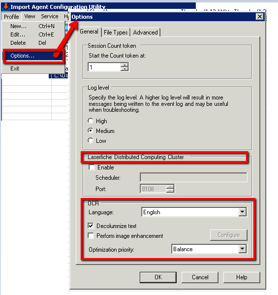

What about your OCR settings? DCC or local OCR? How to see the configuration is attached. Could you please try it on your local machine and import it again? Thanks.

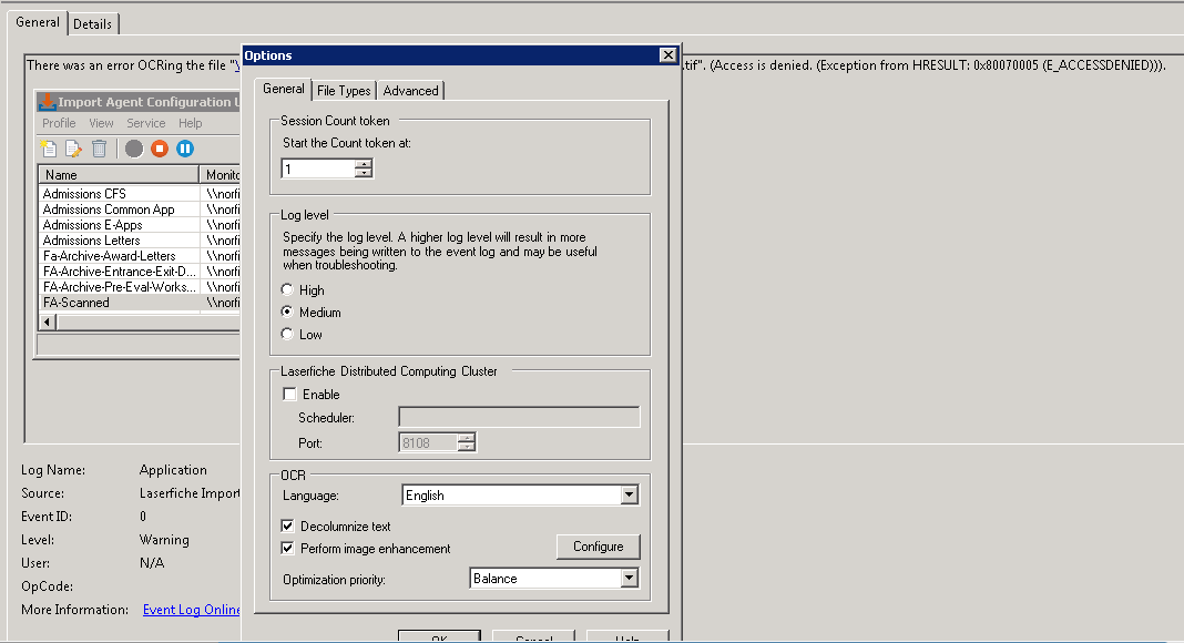

replied on February 29, 2016
Local OCR. Attached image foreground has settings. Background has and error in the event log from a few minutes ago.
