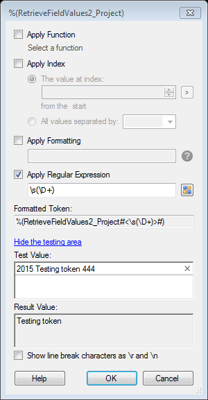

replied on February 19, 2016
Instead of apply function, do Apply Regular Expression with (\D+) to pick up any non digit charaters
replied on February 22, 2016
This works, but I added \s to get rid of the space after the number.
I added a space before (\D+) to get rid of the space after 2015.  Or the other solution was to add \s
token - 2nd.png (19.49 KB)

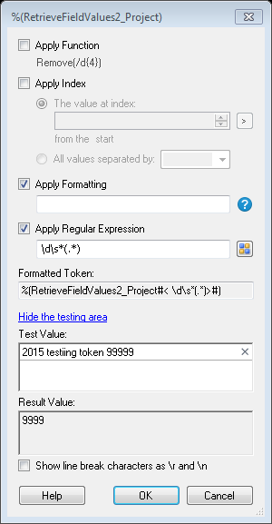

Is there always 4 digit number followed by text?  if so, you can use something like \d\s*(.*)
The solution by Tommy will remove all numeric values, so may be more aggressive than you need/want.
I tried using this solution but it didn't work:
test token.png (15.45 KB)
Actually, that works as written. Your regular expression has a space before the "\d", so it matches the end of the " 99999". You have the space, then first "9" is covered by \d, then zero or more spaces (zero in this case), then some other characters.

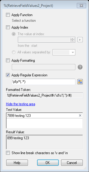

I tried it without the space, and this is what I got:
test token.png (15.27 KB)
Your slash is backwards in the regular expression. The function does not support regular expression for the value to remove.
But as Tommy and Bert indicate, you can use regular expression directly to get the numbers out.
