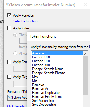

replied on October 19, 2016
I have a similar session I'm building.  I caught your comment about "Remove Duplicates" within the Token Dialog Box!  I would like to see how to use that function, but I cannot see it.  Can you show me how to get that set up?  Oh, never mind, I found it.  Posting here for anyone else wondering about this:
