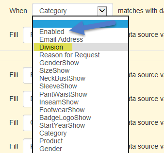

Does anyone else have this problem with Forms?  We are currently in 9.2 but it has been happening for me for a while.  When I make choices when setting up the look up rules, no matter what I choose, it always fills in the first choice on the list and then I have to go back into the drop down and choose what I want again.
When I have a form with a large number of rules, it is a bit annoying to have to choose everything twice.  Does anyone know what this happens or how to fix it?
Starting with a blank rule:
Make a choice for the first box (Enabled is the first choice on the list but I choose Division):

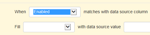

Result of choosing Division:

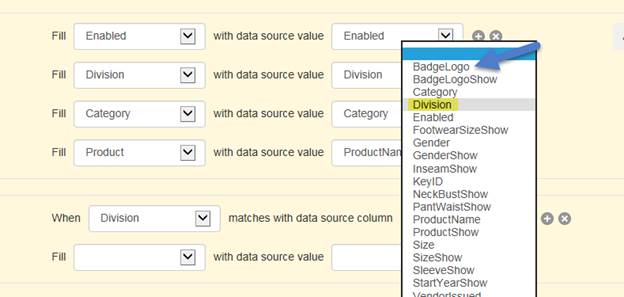

Here I have to go back into the drop down box and rechoose Division.  After that I choose Division for the second box (Note BadgeLogo is the first on the list):

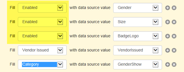

Result of choosing Division (at this point I have to go back into the drop down to rechoose Division):
This happens for EVERY choice.  Version 9.1 and earlier, it was just random time that is would do it.  With the upgrade to 9.2, it happens every single box/choice of every single rule I write.
I also have the random issue of when I have 3 – 4 (or more) When or Fill lines in a rule, when I choose the third or fourth (or later) rule, it takes all the previous lines about it and resets them all to the first choice.  Sometimes when I rechoose the last box, it will reset everything it just changed, sometimes it won’t.

Are you using IE11? This is a bug in Forms 9.2 and the workaround is to use Chrome/Firefox instead.
Sorry for the inconvenience.
