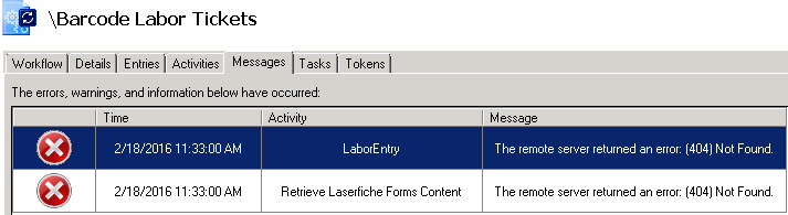

Retrieve Form Fields returns "(404) Not found error
asked on February 18, 2016
Running Forms 10 and LF 9.2.  Forms and Workflow are both running on the same server.
Attempting to retrieve metadata from a form 'Employee Daily Work Report' and then ultimately store the data for each document as a csv and name the csv after the stored document name.
This is the error I get when i run it:

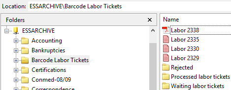

I have 4 documents in the Barcode Labor Tickets folder that I am trying to scan for the metadata.

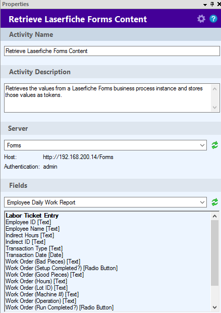

Can you attach a screenshot of the properties for the Retrieve Laserfiche Forms Content activity?

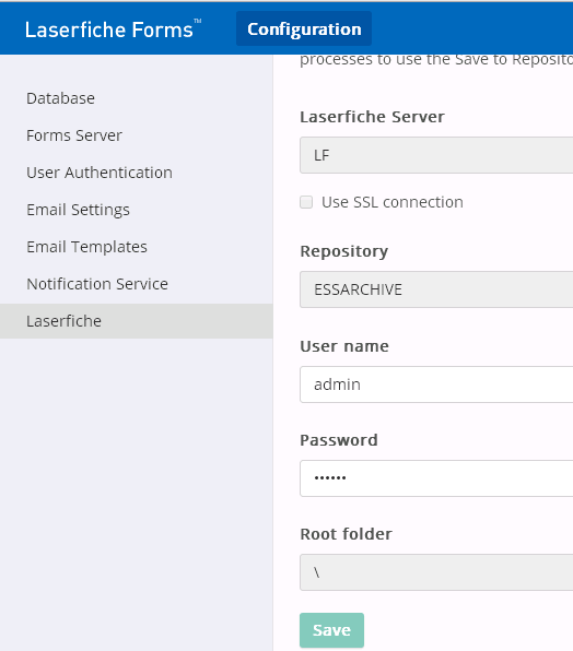

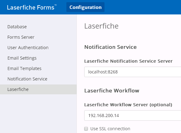

In the Laserfiche tab on the Forms Configuration page, do you have the Workflow server set up?

Is this what you were inquiring about when you asked: In the Laserfiche tab on the Forms Configuration page, do you have the Workflow server set up?
I tried using the IP and the Server name as well.

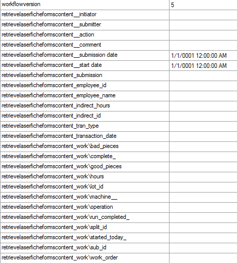

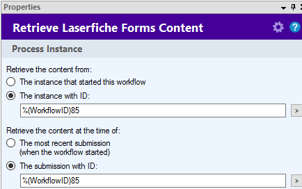

I removed the WorkflowID settings and now I am no longer getting the error.smiley
However, I am still not getting any metadata.  (If I am understanding this correctly.)

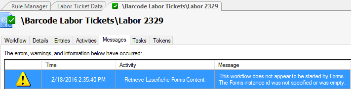

Might this message be a clue?
replied on February 18, 2016
The instance and submission ID would be Forms values, so %(WorkflowID) would definitely not be a value Forms would know about. And adding 85 to the end of it would not help. That's what the 404 was about.
The error in the warning happens when you have the activity's advanced properties set to "the instance that started this workflow" but start the workflow either manually from the Designer or through a starting rule.

Depending on whether you need to do something to the document Forms creates in Laserfiche or you just want the data processed, you have 2 options:
  1. Start the workflow with a document creation starting rule. Forms would have to write the instance ID and submission ID to fields. Workflow would read them and use them in the Advanced Properties of Retrieve Forms Content to get the right form.
  2. If the document is irrelevant for what you want to do in WF, you can start the workflow from a Forms Service Task. In that case, you would leave the Advanced Properties of Retrieve Forms Content to their defaults of "the instance that started this workflow" and Forms would pass that information in when in.
