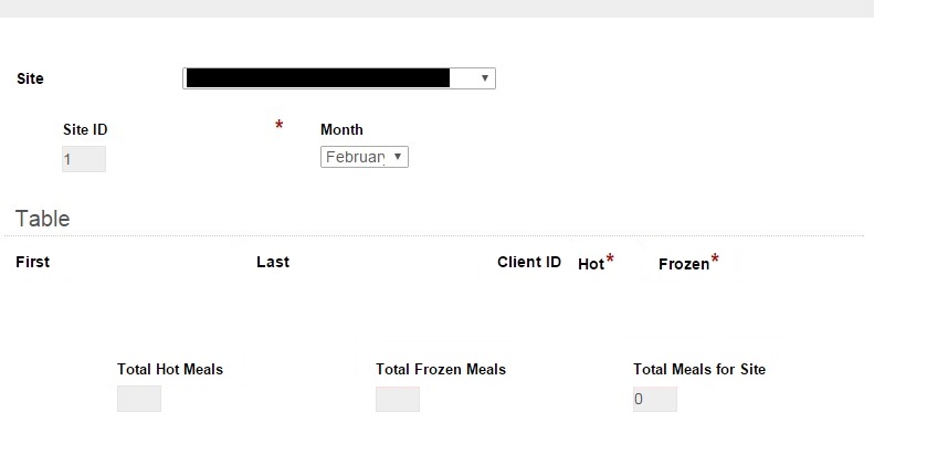

That seems like the form would be more complicated than the users want. I attached what I would like the form's layout to be  based on a test form I made. I want to table to populate from the clients assigned to each site and just have a hot and frozen box to be filled out.

Oh I see, yes in that case you'd need a table that has a list of the client's first name, last name, ID and corresponding site, then use a lookup rule to fill the table data based on the site that's selected.
