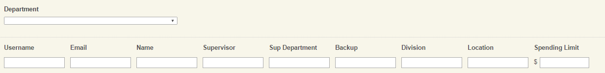

Sorry for jumping in on this thread, but I'm trying to do roughly the same thing, except that I'm pulling data from a look up table. I can't seem to get the code (referenced above) to work in this instance.
When I select a particular department from the drop down, all the fields below are filled with the corresponding data from the SQL table. The number of rows expand according to the number of users in that department. In the SQL table, the domain precedes the user names like this: domain\username. I'm wanting to automatically remove the "domain\" portion and end up with just the username in that field.
Might you have a suggestion?
