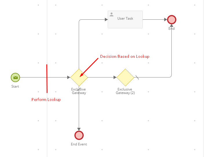

We have a situation where a conditional decision needs to be made in the Forms 10 process modeler, based on a database lookup value. The submitter should not be able to see this lookup value.
We cannot use workflow to do the lookup because as far as I'm aware any values from workflow have to be passed back into a field on a form, but since there is no other form before the decision (as shown below) we can't pass the value back into the process modeler.
The only way I can think of doing this is to have a lookup rule on the starting form which populates a hidden field. Is there a better way of getting this data? Ideally the lookup would be done within the process modeler but I don't think this is possible.

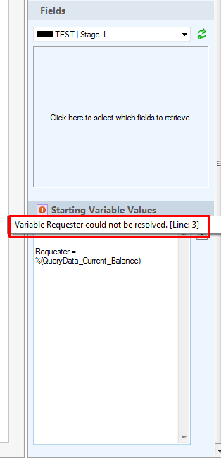

This is what we originally planned to do, however when looking in Workflow don't you have to select fields to retrieve before you can set them in the "set business process variables" activity? (see below)
I get an error if I don't select a field that exists on the starting form, and there doesn't seem to be a way to retrieve variables - only fields

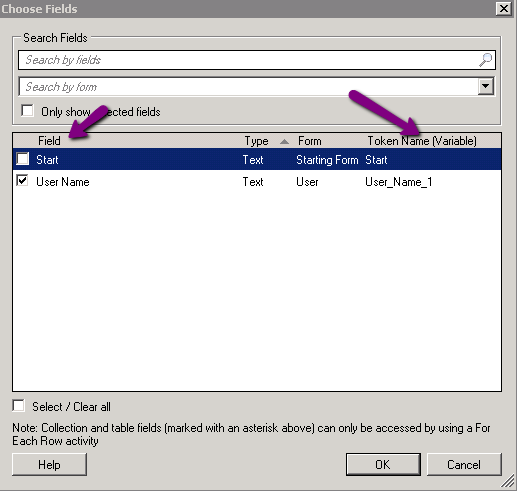

replied on February 17, 2016
The activity sets variables. The user interface shows both fields and variables, it just makes fields stand out more because that's how most users think of the form data.

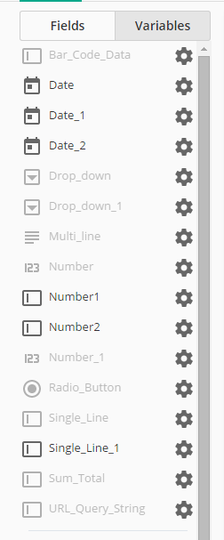

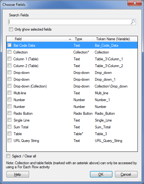

Thanks for your reply Miruna! However I don't see all the variables that exist in my process? The below are screenshots of a test form and workflow I have made.
In workflow I can only see the variables that are actually fields on the form (i.e. that are greyed out in the forms variables pane), the variables that aren't fields (i.e. all 3 date fields) can't be accessed - is this expected behavior?
Thanks for your help! Dan
replied on May 18, 2016
Sorry for the super late reply, I didn't see this post until today. Yes, this is expected behavior, only variables associated with form fields are available for use in Workflow. Since the rest of variables cannot be set or used in processes unless they are associated with a form, there was no good reason for us to expose them in Workflow.
