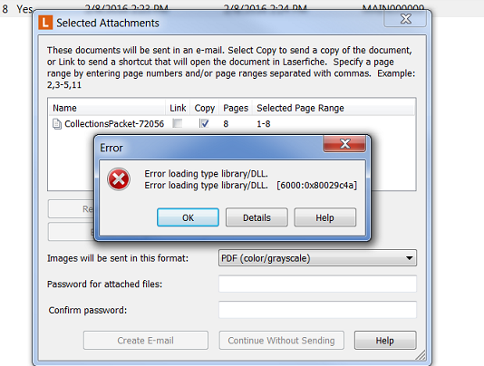

My coworker is getting this error: (See attachment)
When she goes to Email document/pages.
I've seen it before and a simple LF upgrade solved the issue. I upgraded her from 9.1 to 10 in hopes that it would solve it, but she's still getting the error.
Any help is appreciated, thanks!
Error

Is Outlook working properly? The error indicates that there is a problem loading an Outlook component that is used to compose the email. What does it say in the "Details" dialog?

Error Code: 6000
Error Message: Error loading type library/DLL.
Error loading type library/DLL.   [6000:0x80029c4a] (Error loading type library/DLL.  )
------------ Technical Details: ------------
LF.exe (10.0.0.994):
    Call Stack: (Current)
        CEmailSender::SendEmail
    Additional Details:
        Exception: 0x80029c4a [6000] (Error loading type library/DLL.) (CEmailSender::SendEmail at EmailSender.cpp:92)
    Call History:
         CEmailDocument::ExportToFile
          GetOptionString ([Settings]ExportLoopTimeout)
           CAttachedRepository::GetProfileValue
         GetOptionString ([Settings]ExportEmailUseOutlookObjects)
replied on February 8, 2016
You can try repairing Outlook since it appears to be failing to create the email through the Outlook interface. If that doesn't fix the problem, please open a support case so we can debug it further.
replied on February 9, 2016
Thanks Robert, I'll give it a repair and if it doesn't work, I'll go ahead and open a ticket.
Was having issues repairing Outlook. I uninstalled the whole Office suite and reinstalled it with 2016 apps. It's working again. thanks Robert!
