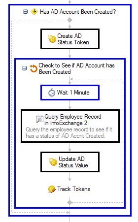

We have several workflows that were not completing as expected. To troubleshoot the problem I added the Track Tokens activity into the workflow in question. I then published it and told Workflow to update instances that are currently in progress. This specific workflow has a step that repeats every minute until a condition is satisfied. Even after that minute, the Track Tokens activity is not being ran and I cannot figure out why. Does anyone have any suggestions? Below is a screenshot of the setup.

The currently running activity will not update. In this case, the currently running activity would be the Repeat.

If that is the case, there is no way for me to see what values are being evaluated? Am I able to change a value in the database so that it will move on?

That's correct. You can't add Track Tokens after the loop starts.

The main issue for this particular problem is that the "Query Employee Record in InforExchange 2" activity should be querying a SQL database for a specific ID number and then the Update AD Status Value updates the respective token with the value from the Status column from the previous lookup. The "Check to See if AD Account has Been Created" repeat evaluates if the status of that token is set to "AD Accnt Created". It not, go back through the repeat. In the database though, the record does have the status column set to that value. What would be the best way to troubleshoot why the workflow instance is not seeing that? I have tested the database connection and it works correctly.

If you restart the workflow, the new instance would run Track Tokens since it would run with the updated definition.

Say it aint so Joe! The workflow in question is part of an onboarding process that is started within Forms. It would have to go back through a long approval process before it hits the workflow again. Is there no other way?
replied on February 4, 2016
Sorry!
How about a copy of this WF that retrieves the form data from this specific Forms instance to start (rather than being started by Forms)? Just so you can troubleshoot the WF part independently of the bigger process?
