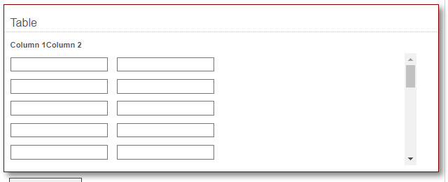

I was able to make a table scroll by this simple CSS
.itemTable {height: 320px; overflow-y: auto;}
I have attached the screenshot. The table class is itemTable. The problem is it scrolls together with the column headers. I need help to make the column headers static. Thanks

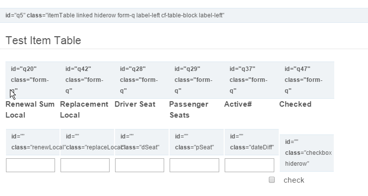

I tried this code but I get this result with the Column Labels
I tried the Row Widths set Auto and by setting the width values and see the same results.
Thoughts?
