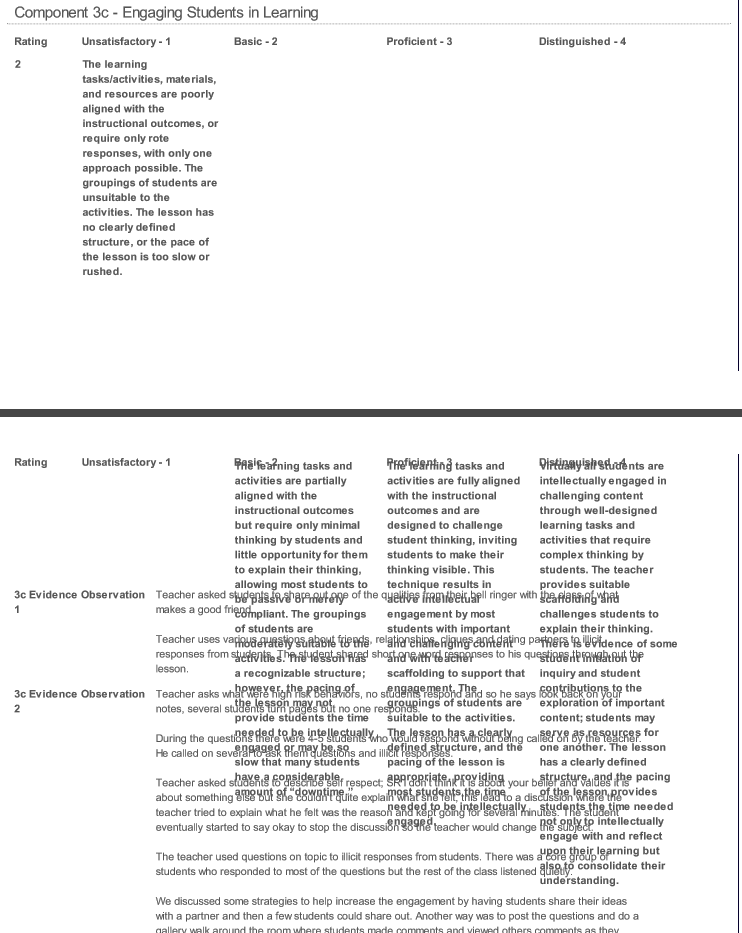

We have a Forms process that has a form with multiple tables in it. The tables vary in length. After the tables are muli-line text fields that can vary in length as well. When the form is finally saved into the repository the values in the table columns or overlaying the multi-line text fields. It does not happen with every table, but some. See a screenshot below. Does anyone have any ideas on how to correct this?

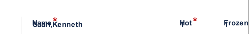

replied on February 25, 2016
Mine does the same thing it has the table column names overlapping with data

replied on March 1, 2016
I tried that but I think it is more a length issue as my look-up rule generated table is longer than one page the column headings repeat on the second page

Hi Aaron,
You are right. the column name will overlap with the data when the generated table is longer than one page; and this is a known issue with wkhtmltopdf, but not a bug in Forms.
Maybe you can try the solution in http://stackoverflow.com/questions/24648383/wkhtmltopdf-repeating-thead-headers-overlapping-content ;
I tested using the solution in the link and just added the CSS rule in the form:
tr { page-break-inside: avoid; }
Then all things will work well when save to repository.
