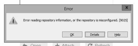

I have a vendor that I had upgrade their VM to more cores for a large OCR project. They double the cores from 2 to 4 but now I cant log in. As far as I know, nothing else has changed. I just get this error.
Where do I start on this one?

replied on February 3, 2016
Error Code: 9025
Error Message: Error reading repository information, or the repository is misconfigured. [9025]
------------ Technical Details: ------------
LFSO:
    Call Stack: (Exception)
        CLFConnection::Create
    Additional Details:
        HRESULT: 0xc0042341 (ProcessResponseHeaders, LFSession.cpp:4887)
         (LFSO/9.2.1.518)
LF.exe (9.2.1.562):
        CLoginDialog::AttemptLogin
        CLoginDialog::LoginToServer
        CLoginView::LoginHandler
    Call Stack: (Current)
    Additional Details:
        Exception: 0x80042341 [9025] (Error reading repository information, or the repository is misconfigured.) (CLoginDialog::AttemptLogin at LoginDialog.cpp:792)
    Call History:
          GetOptionString ([JSDLFSettings]AdminNoPassword)
          GetOptionString ([JSDLFSettings]UserName)
          GetOptionString ([Settings]UseWindowsAuth)
          GetOptionString ([JSDLFSettings]UseWindowsAuth)
           GetOptionString ([Settings]CheckServerVersion)

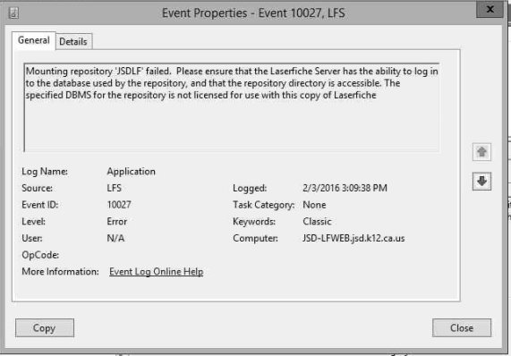

I ran the activator tool which put the license file on the desktop. I just now copied it over to the server folder under program files and overwrote the old one and restarted the laserfiche server service. Still same error. Here is the event viewer.
Just adding more CPU cores to the VM shouldn't affect how the server connects to SQL so there may be something else going on. You may want to create a support case at this point so we can investigate further.

Is the error logged in the event viewer the same one about not being able to mount the repository? Is SQL on a different machine? If yes, have you checked whether Windows Updates re-enabled the firewall and cut off communication between the 2 machines?
replied on May 22, 2018
the same error are logged in the event viewer. They use Oracle and is on a cloud.
Firewall is off. We can test the connection and comes back successful.
Does your license have an Oracle flag?
replied on May 23, 2018
It was a mismatched hardware fingerprint. Issue is now resolved
