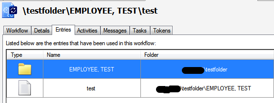

I am trying to write a workflow that will pull the Employee ID field from the document's metadata and apply it to the parent folder. Everything that I tried gave me the error of entry could not be found or the workflow gets stuck. Right now I'm doing it in a testing environment and heres the path:
testfolder\EMPLOYEE, TEST\test doc [with employee ID #1234]
the result I'm looking for is:
testfolder\EMPLOYEE, TEST [with employee ID #1234]\EMPLOYEE, TEST [with employee ID #1234]
When running the workflow, it gets stuck finding the field values, however the workflow will find the document and parent folder entries
Its a simple workflow for testing purposes only

replied on February 3, 2016
The parent folder has the same template
I used an even simpler copy metadata workflow and that worked. All it consisted of was:
find entry with the token %(Entry Path) and Copy Metadata [copied from: Starting Entry and Copy to: Other entry pointing to Find Entry path token]
Both workflows started from: testfolder\EMPLOYEE, TEST\test doc but only the copy metadata worked
