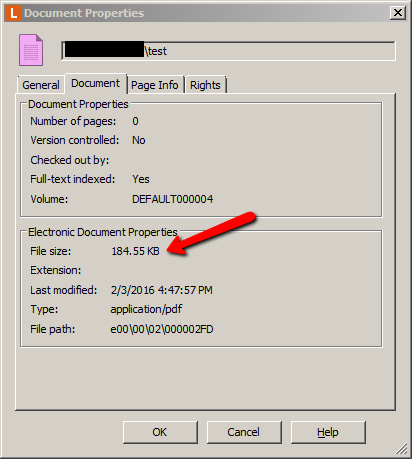

replied on February 3, 2016
Are you sure nothing is being written? Check the file size in the document properties (screenshot below). The entry icon won't change with this code because it isn't changing the extension.

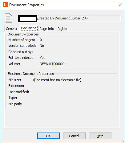

Here are the properties on the document.

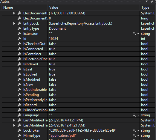

I tried adding the a try and catch below but the catch is never hit.  When I step through the code, I can see the mimetype being set for the docInfo object, but not for the electronic document content itself.
