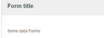

Hi Chris,
I have found that this method can be used for fixed variables such as Current User Name.  But it does not work for Field Variables.  They always appear as blank.  I am using a Default value in the field to test this.
The variable shows in the field on a submitted form but not in Custom HTML.
e.g.
<p>Some data {/_currentuser_display} {/dataset/Image_Select}</p>
where image select = any value, shows
  Any suggestions?
replied on February 3, 2016
Thank you again Chris..that's worked for me..
