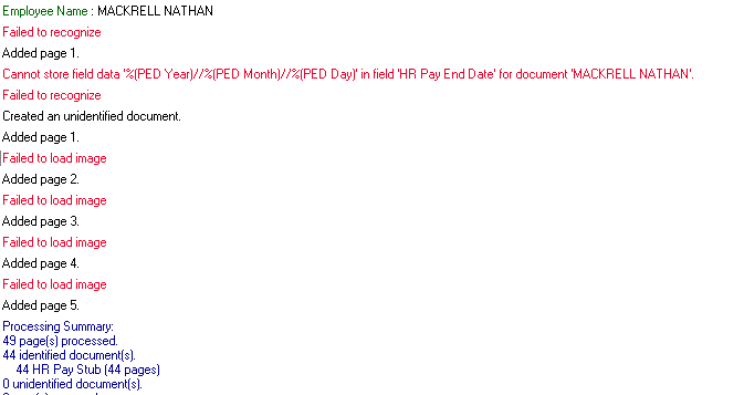

I have a Tiff document that has 49 pages.  Total file size is 23,000 KB
When I run this through my quick field session it works well up to the last 6 documents and then seems to freeze. (as shown below)  I can rearrange the page order in Laserfiche and the below failed documents will work and a different set of 6 will fail.
Message count is 637
If I drop any 6 pages and make it 43 pages. It process without errors.
I am seeing this same thing in another Quick Fields session where it does not like any thing over 100 pages.
Is there a memory limitation?
Am I trying to do to much in quickfields?

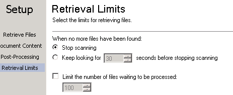

The only thing that I can think of, inside Quick Field, would be under Tools -> Configure Scan Source -> Retrieval Limits. I'm not aware of Quick Fields having a memory limit. I have folks that scan in +50 page color PDFs without much trouble.
Outside of Quick Fields, if you have templates being assigned, would be to ensure you don't have any limits there. Additionally, double check hard drive space.
Good luck!
replied on February 3, 2016
I do not have any retrieval limits set.

So today I had our third party IT company in testing the system with me.
When running QF session it starts a program called LFOmniOCR.exe
As the pages are scanned and documents created from each page the committed memory climbs. Once it hits 1.8 GB that is when QF fails.
This appears to be a memory issue.  Once a page is processed and document created the LFOmniOCR.exe is not releasing its resources. It just continues to add to the committed memory. Very repeatable with multiple document types and differrent QF sessions

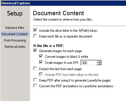

That's interesting QF is expanding a 23,000 KB by ~100 times. Since you're using QF I'm assuming the documents are going to a network location first. Are they being stored as a PDF or a TIFF? If they are being stored as a PDF, do you have your sessions setup to store it as an image?
replied on March 15, 2016
They are being processed from Scanner Tiff and put into laserfiche as Tiff
As a test, have you tried a different file format?
