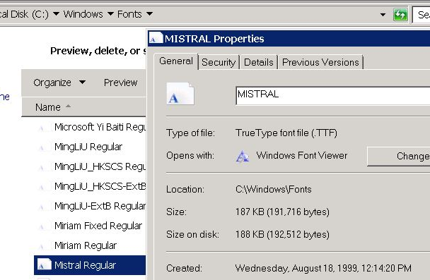

I'm trying to fill out specific pdf input box using a custom font and it doesn't seem to be working as I expected. My end goal here is to use a barcode font in order print dynamic bar codes on a cover sheet. So if there are any tips or advice as to what i am dong wrong, they are grated appreciated. Below are some screenshots of me trying to use a font (not barcode) but I couldn't even get that working.
Here is the font i'm trying to use

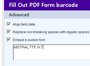

And here are my settings in WF
I've tried other combinations of settings following this guide https://support.laserfiche.com/KB/1013512. But all results are the same when i look at my pdf.

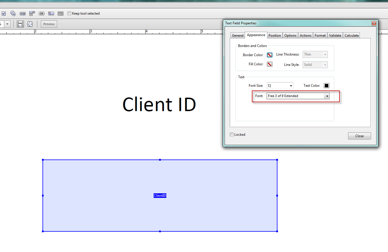

Have you tried setting the font in the Form Field on the master PDF rather than the Workflow Activity?  The attached image shows the setting in Adobe I used.
Barcode Font.jpg (127.53 KB)
