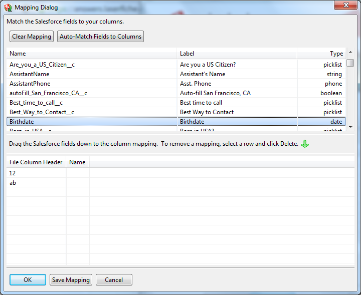

That's kinda what I was thinking. I have this tool called data loader. The guy that was working on this showed it to me as a way to find out what the field names are. The customer has a couple of custom fields that I needed to check the naming on. The input value for birthday just date.
The field in Laserfiche is a date field. I can try to change it to text and see what it does.
