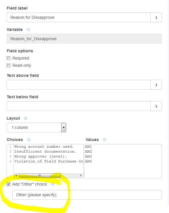

replied on January 26, 2016
Thanks for your reply. maybe if I include a screen shot for the form that would explain it better. So for the "Other" choice below, I'm not sure how to check when that item is selected because I can't assign a value to it like the choices 1-4. I tried looking for "Other" as seen in the script, but it is not working..

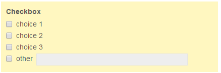

replied on January 30, 2016
That worked! Thanks
replied on April 5, 2016
Chris,
Your script above helped a ton.  Taking this a bit further, I would like to know how we can input a value in this 'Other' field.  I have the following code that is checking the box correctly, but no value is being added to the 'Other' input field.
I would expect you could target it using:
$('#OtherField18').val('Text');
I misread the below. Chris's answer below is spot on.
That worked - I needed to take out the 'input' as well, but I got it to work.  Thanks for your help Chris!
