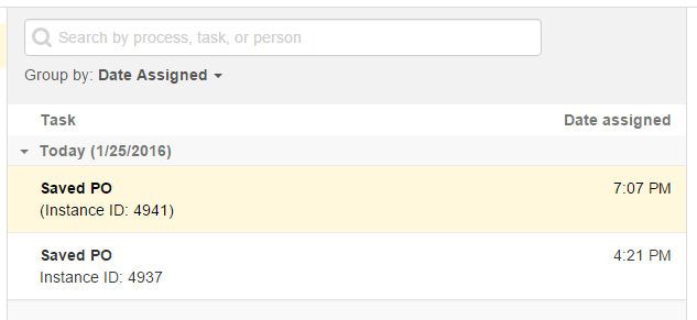

Users' Inbox currently looks like this:
We're trying to replace the "Instance ID: XXXX" with a field variable, such as a PO Number. That way, users can quickly identify which PO they will work on and finish.
Is this possible?

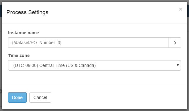

We placed the PO Number field variable inside the instance name in Process Modeler settings, but that didn't help:

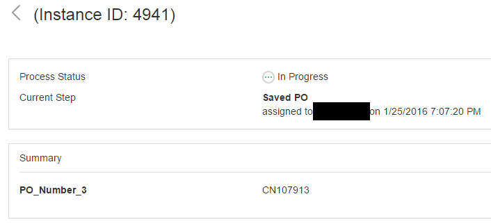

We were able to show the variable inside the Process Information section, but that's too hidden.

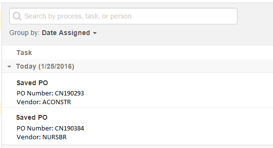

Below is a "photoshopped" version of what I'm looking for. Variables don't have to appear as a new line, but it would help.
P.S. I'm also trying to understand why, in my first screenshot, the first task has the instance ID in parentheses while the second task doesn't.

It seems the reason is value for "PO_Number_3" is empty when the instance started. Do you have a message start event with a form as the start event? When fill that form, is field for PO_Number_3 filled with value? If the token used in instance name are parsed as empty, then it will give it an default name which is (Instance ID:{instance id))(that's why the first task has instance ID in parentheses). The instance name is generated when instance is started and can't be updated.

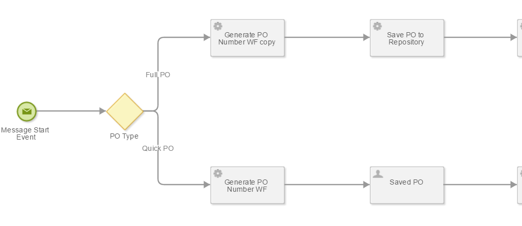

Yes, the PO number is initially empty when the instance is started. After the form is submitted, Workflow calculates it and inserts it into the cf_bpdata table for that submission_id (we figured out its attribute_id). See the "Generate PO Number WF" activity below:
We tested this and it works fine. When the user opens the form in the "Saved PO" step, it displays the PO number. We just need it to also display under the task name in the inbox. How do we change the instance name dynamically? Can we also update a value in the database?

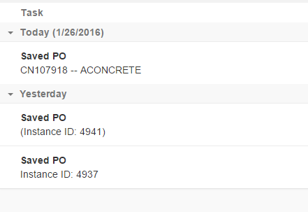

OK, figured it out. It's the title column on the bp_main_instances table. We're able to have Workflow update that too when it generates the PO number. See the topmost task below:
