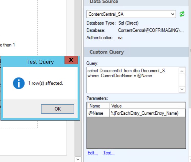

First query, i look up a documentId using a document name in the Document_S table
Second query, I look up DocumentFieldValues using the documentId from the first query in the DocumentField table.
My issue is that the documentId is not available for me in the second query. I know the column exists and I know my test result is returning a hit. I write it using search syntax thinking it would help, but same error occur.
This first screenshot shows the first query. All is working fine.

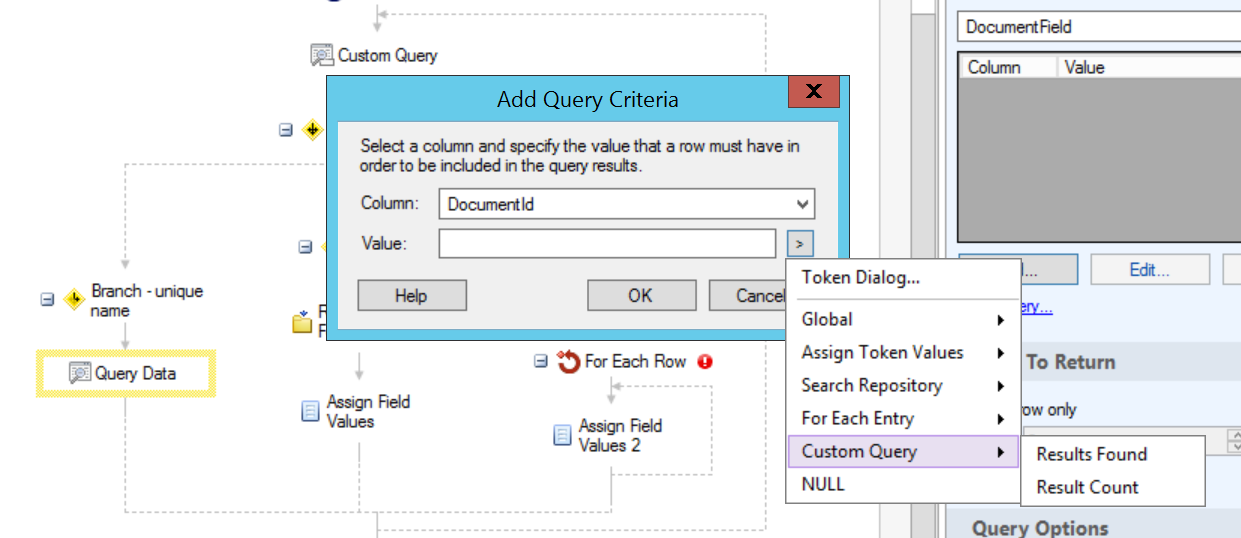

Second screenshot shows myself trying to access the column that was pull. As you can see, its not available.
Suggestions? What it should return is a documentId for example "61ef8346-950d-49ed-b26f-0001d855860e". I thought it might be the formatting, but i can't even save it to a token, that column is just not avaiable.
replied on January 22, 2016
A support case was created for this. It appears that DocumentID is a uniqueidentifier column type in SQL. Using this custom query addresses the matter
select cast(DocumentID as nvarchar(36)) as 'DocumentID' from dbo.Document_S where CurrentDocName = @Name
If you open the Token Dialog, is the column listed there under Custom Query?
I checked that as well, it is not
