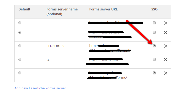

Hello Eddie,
there are usually 2 things that will result in this issue
1) Please ensure that the "SSO" check box is checked as shown here
2) Another thing to also note, is to make sure that in the mobile configuration page,
as shown here, you have your laserfiche directory server configured, and also you have the right Organization set up.
