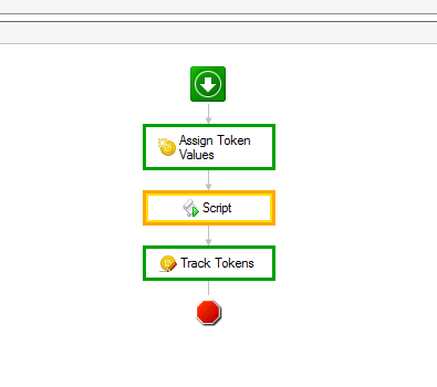

Here is a screen shot of the bare bones workflow;

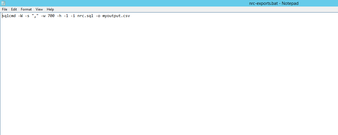

in your bat file, you have references to 3 different files and do not supply a path to any of them.  The SQLCMD is probably fine since it should be in the path variable (but I would still provide full path), but the other 2 most definitely need full paths supplied.
change to something like
Also, any files referenced inside of the nrc.sql script also need to have their full path defined.

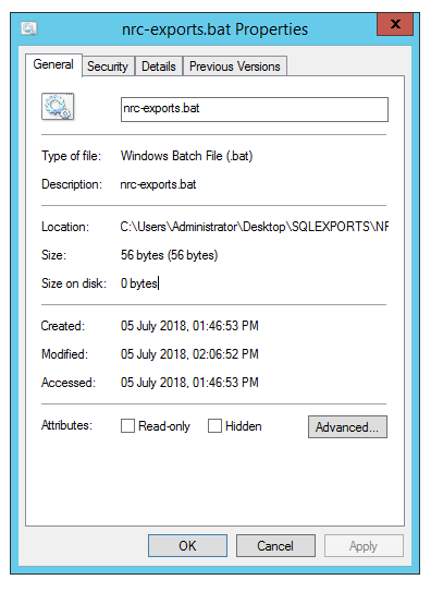

I have the same problem here. I am using your script to run a .exe and it works perfectly.
Now I have a .bat file that runs a sql query to export a sql table to csv.
The script does not execute the .bat file even though the Workflow returns no errors.
What could be wrong?
replied on July 9, 2018 • Show version history

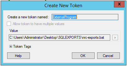

What is the value of your "ExternalProgram" token?  Is it the full path to the bat file?
Are you providing the full path to any/all files that your .bat file and sql script accesses?

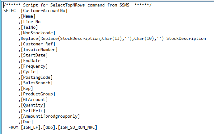

I am not referencing anything specific in my SQL Script:

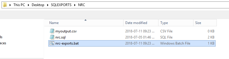

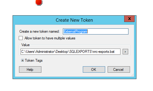

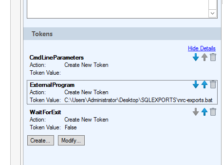

I changed the paths of everything as you instructed:
Workflow still looks like:
When running the .bat by double clicking it, I still get my expect result:
I am a flat out of ideas over here.
I am about 105% sure everything is pointing in the correct direction, the bat file is where it needs to be, etc.
Help please!

Perhaps a permissions issue with Workflow accessing the folder where you have the batch file?  I would move the bat file to a more generic folder, perhaps creating a test folder off of the root of C: and making sure the folder allows access to all users.
replied on July 11, 2018 • Show version history
Did you verify that the "C:\Program Files\Microsoft SQL Server\110\Tools\Binn\SQLCMD.exe" is present on your system?  It may have a different path based on the version(s) SQL you have installed.  If you do not know where to find sqlcmd on your workflow server, open Regedit and search/find "SQLCMD.EXE".  Then check that the file is where the registry is reporting it.
As Cliff states, the user folders are a bit restrictive, so create a folder on the root of C (or on a data drive) and make sure that the user that Workflow "Logs On As" has permissions to it.  Place your .bat, .sql, and .csv files in that folder.
Finally, make sure that the user that Workflow "Logs On As" has permissions to SQL because that is the user that will run the script.
replied on July 14, 2018
This solved it. I moved everything to C:\mypath\mypath2\ and it seems that WF is executing my .bat! Thank you Cliff.
