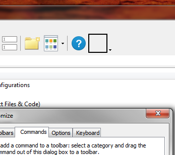

I am working on a project that installs a small utility program and creates a custom toolbar button in Laserfiche to launch it. During uninstall, it also attempts to remove the toolbar button. It appears to succeed in removing the button, but leaves behind an empty space on the toolbar as in the picture below:
You can just drag it off of the toolbar, but I'd prefer if it removed the button cleanly. Here is the code I am using... am I forgetting a step?

RemoveCustomToolbarButton removes the button definition (not the button itself on the toolbar), leaving a "dangling" button on the toolbar. First remove the button from the toolbar(s), then delete the definition:

Thanks for the clarification, that did the trick. (Also... I assumed that your if statement on line 21 was supposed to be "buttonInfo.Id == customButtonId")
replied on January 5, 2016
Oops, thanks. i updated the snippet.
