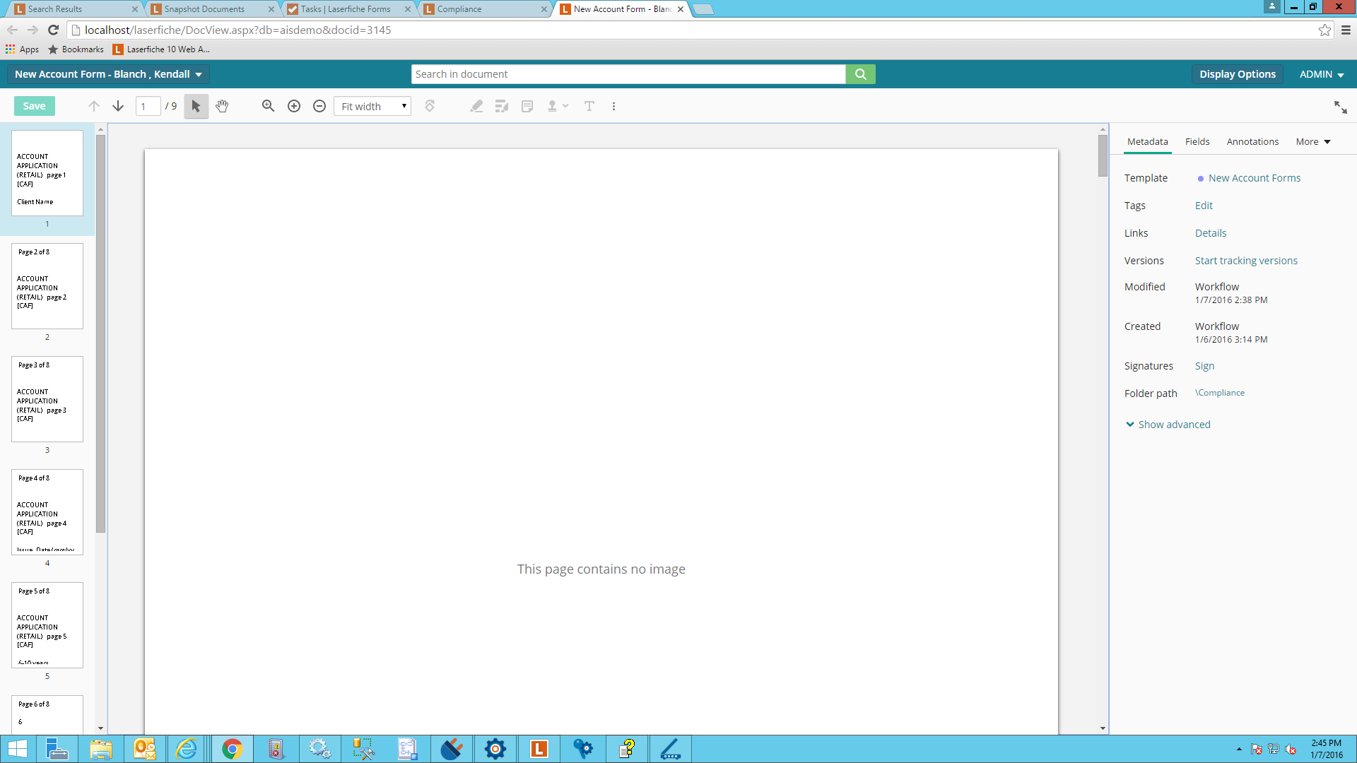

I am talking about webaccess. this is what i am seeing when i embed webaccess in an iframe and try to open pdf file. if i select view electronic file from options i can easily see pdf in new window but why not in webaccess?
replied on January 7, 2016
Have you tried using the link going direct to the electronic file?
https://www.laserfiche.com/support/webhelp/webaccess/9.1/en-us/WA/WebAccess.htm#electronicURLs.htm%3FTocPath%3DURLs|_____2
The DocView url you're using above will take you to the generated images or pages of a Laserfiche entry. Not the actual pdf.
replied on January 8, 2016
Thanks. This is exactly what i was looking for. One thing i would like to mention here is that links structure mentioned above didn't work for me.
 http://servername/laserfiche/ElectronicFile.aspx?db=repositoryname&id=id
Instead i had to use something like this
http://servername/laserfiche/edoc/repositoryname/id/name.pdf
Also, if you send above mentioned url from workflow it doesnt work as /%(id) in workflow token are considered part of url, hence you have to use //%(id) to make it work.

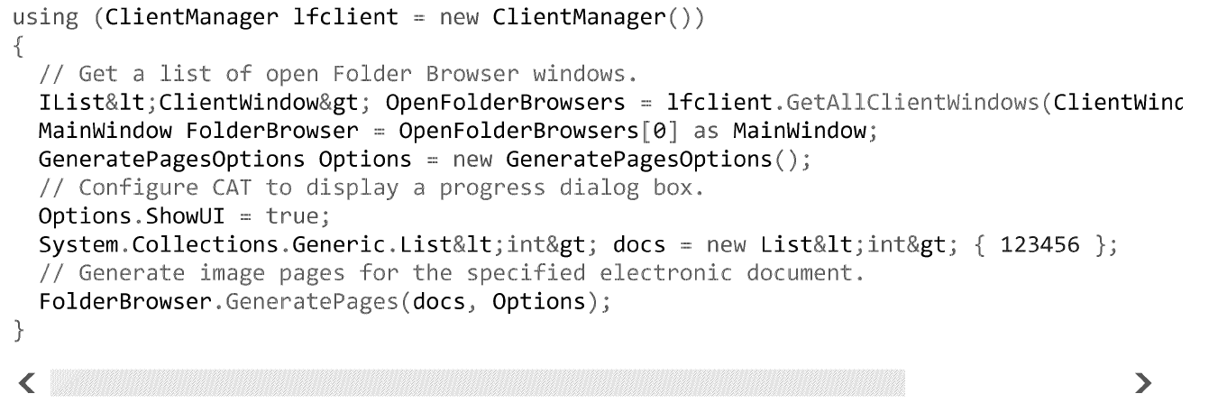

Is there a way to generate pages for specific electronic document from workflow. I am looking into sdk and i have found something but not sure it will work.
replied on January 5, 2016
I have not found a way in workflow but have been able to do it in quick fields.  I am guessing that you are talking about a number of documents and it would not be timely to do it manually in client?
Yes. Converting electronic document Manually to pages is not an option since files are created dynamically and could be in large numbers.
