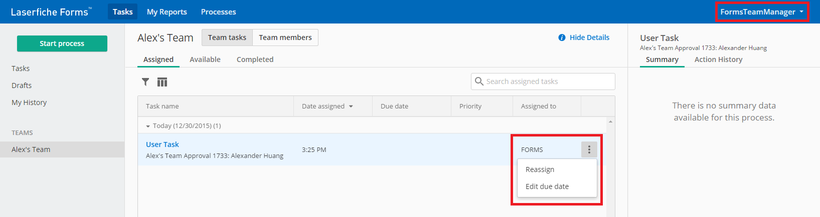

Yes, a team manager can reassign the task. While logged into Forms as the team manager, from the Tasks pane, select the team in question. Then view the "Assigned" tasks and you should be able to click the overflow button to reassign the task. See the screenshot below. It shows the user "FormsTeamManager" logged in and having the ability to reassign a task that is currently assigned to the user, "FORMS."

What I have found is that if a Task has been assigned to a Team and then to a team member, it appears as an assigned task in the Team as you have shown above.  It can be reassigned by a Manager, or reassigned or released back by the team member.
However, if a Task is assigned directly to the team member, without assigning it to a team first it will not appear in Teams (of course!).  Because my admin is a Team Manager he has no control over an individual user and can only see the Task in History.
I was hoping an administrator could release a Task from an individual even if not in a Team.
