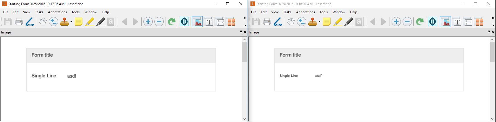

Do you have any other CSS that may be causing a conflict? I created a new business process and form and tested two submissions: one that only uses the three lines of CSS mentioned in the earlier post and one that doesn't use any CSS at all. The business process is configured to save the form submission to the repository as a TIFF image. See the below screenshot for showing the two test submissions in the repository.
If you're running into an issue, even when doing the same test, then please open a case with Laserfiche Support so the matter can be looked into further.
