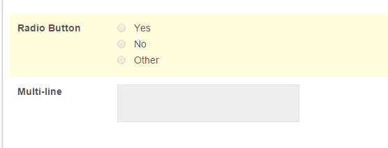

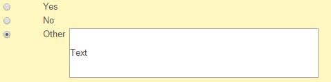

I am trying to figure out how to make the input box for the "other" option on radio buttons to function as a multi-line field.  Right now, I made the input box taller but the line for text only shows in the middle of the box as shown in the image. Does anyone know how to do this?

I don't think you can simply modify the existing "Other box" to be multi line as this requires a different HTML tag.

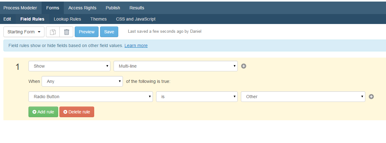

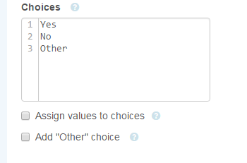

However to get around this you could remove the tick box "Add an 'other' choice" and manually add "Other" to the list of radio buttons. Then underneath your radio buttons have a multi-line input and use field rules to only show it when the "Other" radio button is selected.
