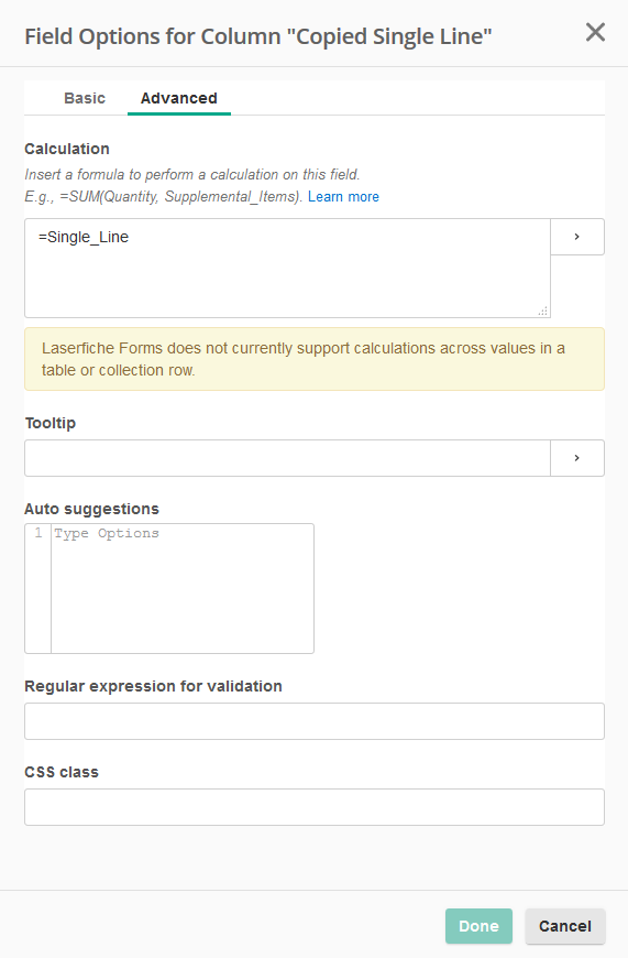

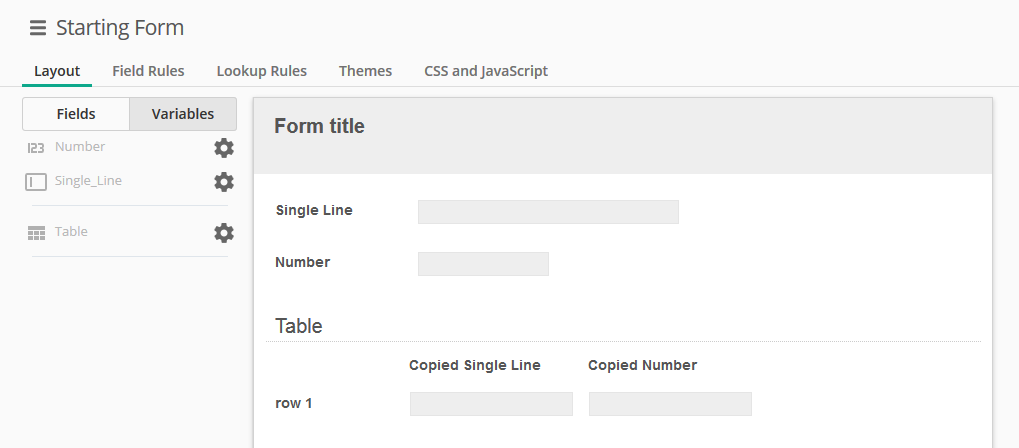

If you are using Forms 10, you can use the new Calculations/Formulas feature for this. For example, here is a form with a single line field, a number field, and then a table that has one row and two columns where the first column will get the copied single line value and the second column will get the copied number value.
I can then give the copied single line field a formula like below
I'd then do something similar with the copied number field. Then when I start the business process and start filling out the form, whatever I enter into the single line field and number field will then get copied into the corresponding fields in the table.

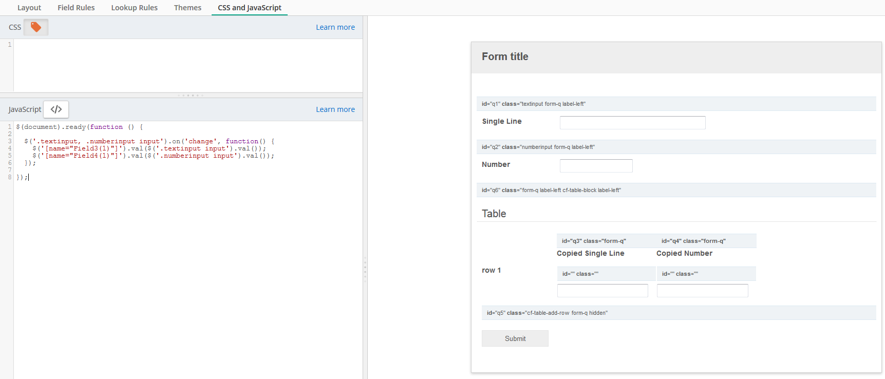

If you are using Forms 9.2, then you can do something similar with custom JavaScript. You can watch for changes made to the input fields and then set the values into the corresponding fields in the table. See the picture below and note the CSS class names for the input fields and the IDs of the fields in the table.

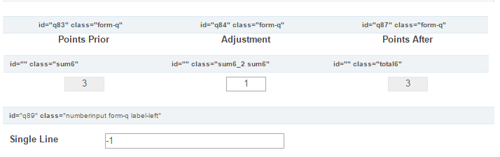

Thanks for the help. I got the copying of the field to work. However, could you help with one more thing? I have the "Single Line" auto-populating a number based on another field. I need the sign of that number to be made negative. Then I need it to copy into the "Field84(1)" within the table. Then I need the calculation to take place of Points Prior + Adjustment = Points After. Right now it looks like the calculation is taking place, then the number is being copied into the Adjustment field ["Field84(1)"], and then the sign of the Single Line is being made negative. How do I go about reversing the order of everything? My code is currently as follows:
		$(document).on('change', '.numberinput input', function() {
			$(this).val(-this.value);
	$('.numberinput input').on('change', function() {
	$('[name="Field84(1)"]').val($('.numberinput input').val());
    }).on('change','.cf-table-block input', sumtotal);
    function sumtotal() {
        var sum = 0;
        $('td.sum6').each(function () {
            var s = 0;
            $(this).find('input').each(function () {
                s += parseNumber($(this).val());
            $(this).find('.subtotal input').val(s);
            sum += s;
        $('.total6 input').val(sum);
      	if ($('.subtotal').length > 0) rowtotal();
    function rowtotal() {
        var sum = 0;
        $('.cf-table-block tbody tr').each(function () {
            var s = 0;
            $(this).find('.sum6 input').each(function () {
            sum += s;
    function parseNumber(n) {
        var f = parseFloat(n); //Convert to float number.
        return isNaN(f) ? 0 : f; //treat invalid input as 0;
You can see how it's adding 3 + 0 = 3. Then inputting the 1 from single line. And then changing the sign within the Single Line field.
