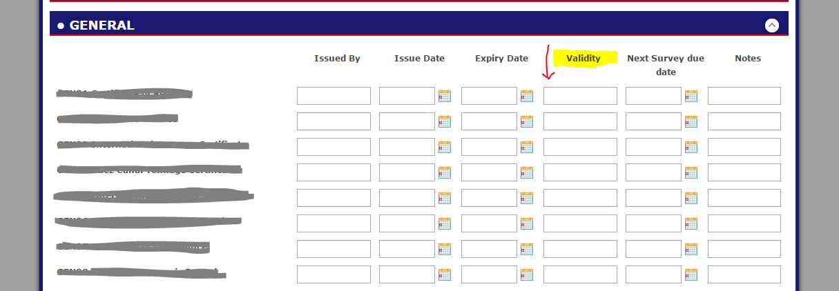

I have the table below in one of my forms. For all columns apart from the 'Validity' column, participants must complete the rest of the table themselves.
I would like the information in the 'Validity' column to be input by me and made 'read only'. Is it possible to do what I want? If not any suggestions would be greatly appreciated.
Thanks.
Christian

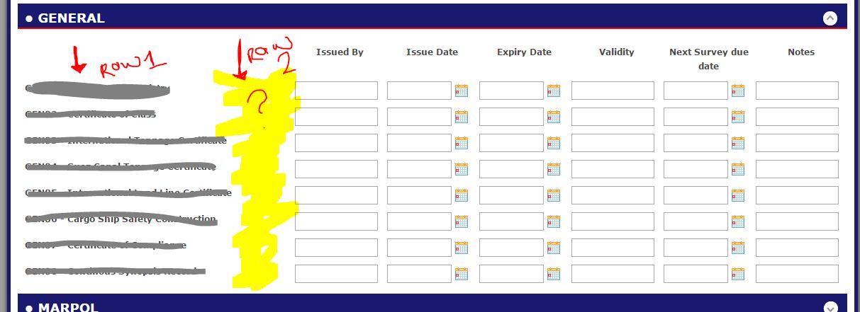

Hi Chris,
Perhaps I didn't  explain myself properly. I basically, as in the picture of my Form at the moment, have a table with Row and Columns. I have rows for my table attached, I am wondering if I can insert a second set of rows? See Row 1 which is standard with the table feature in Forms and see where I would like to have the same number of cells for Row 2 alongside Row 1.
I hope this clears up what I am looking for.

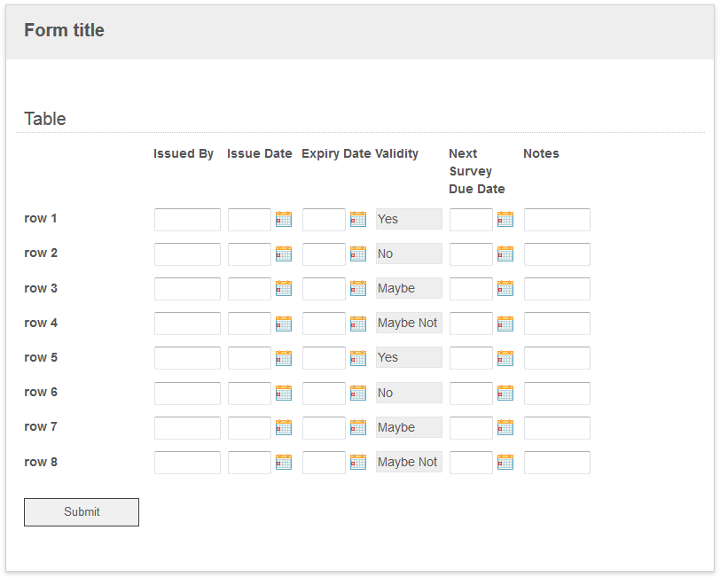

replied on December 15, 2015

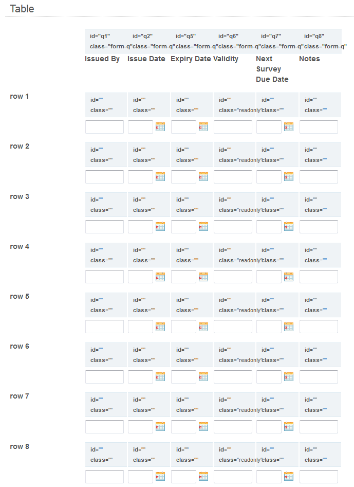

Please see the example below. Give the validity field in your table a CSS class name like readonly. Next, go to the CSS and JavaScript page in Forms to find out the ID of that field. Here, you'll see the ID is 6.
Then add the following JavaScript
  $('.readonly input').attr('readonly', true);
  $('[name="Field6(1)"]').val("Yes");
  $('[name="Field6(2)"]').val("No");
  $('[name="Field6(3)"]').val("Maybe");
  $('[name="Field6(4)"]').val("Maybe Not");
  $('[name="Field6(5)"]').val("Yes");
  $('[name="Field6(6)"]').val("No");
  $('[name="Field6(7)"]').val("Maybe");
  $('[name="Field6(8)"]').val("Maybe Not");
You would use your own values, but basically, the code will make that field read only (it's important to do this with JavaScript and not in the form designer UI) and will assign specific values to it.
The result would be
