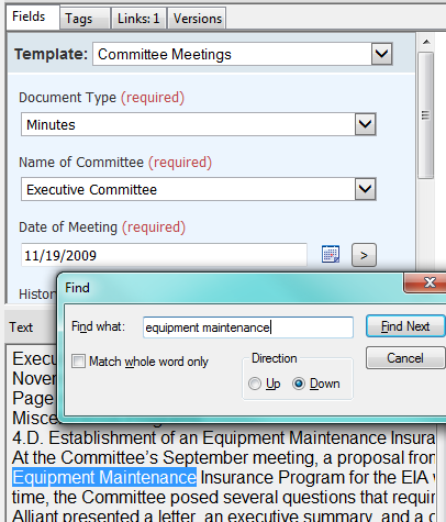

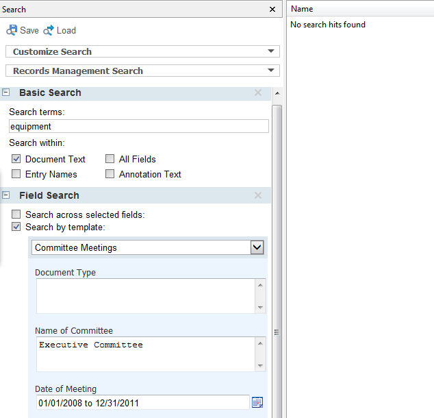

I am searching for the text "Equipment Maintenance" in document text in my repository. I had it narrowed to the template, type of meeting file and even the date range that I wanted it to look through and it came up with zero results. I tried using wild cards to account for misspellings or OCR mistakes, but still nothing.
I then went in to each and every document in my date range to try to find it manually and it is most definitely there. A Ctrl+F even finds the exact phrase in my OCR'd document, several times in fact.

Also, the search screen shot looks like different fields then the document metadata screen shot (looks like text fields in search and list in metadata).  Was your search on the same repository that the found document is in?

The search was the same repository that it was found in, we only have 1. Both the search metadata and the document metadata are drop down lists. The search I am mimicking the metadata assigned to the document.
I should mention that I eliminate the date range, only search for "equipment" and I get several hits, but not for what I was looking for. It appears that sometimes the text search is working, and sometimes not, which is not reassuring.

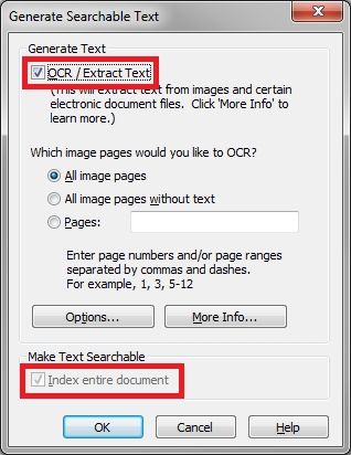

If you re-OCR or extract text and re-index the document, does it return in text searches then?
replied on December 10, 2015
Yes, re-OCR-ing that one document did make it show up in a text search. Does this mean I have to re-OCR my entire repository to make this work? (This is not a good option!)
If the text does exist for the documents, then you may just have to re-index and not need to re-OCR or extract text again. This can be done from the Index node in the Laserfiche Administration Console. Instead of re-indexing the entire repository at once, you can also do this volume by volume. Alternatively, you can also use the Quick Re-index utility that ships with Laserfiche. The benefits of this is that it's faster than re-indexing through the Administration Console and can be done while still allowing users in the repository to perform text/indexed searches.
To expand on what Alex said, I'm pretty sure the documents are OCR'd since you're clearly showing the text pane for the document above. You could confirm that it simply needs to be reindexed by going to the same Generate Text dialog, but unchecking OCR (so that only the grayed-out index checkbox is checked). Reindexing your search index is almost certainly the way to go here.
Thank you! I found where and how to do this. Before I go ahead and do it though, might there be any unintended consequences of re-indexing? Is this going to create any noticeable change or slow anything down for our users when I do this?
Reindexing basically wipes the index and recreates it from scratch (that's an oversimplification, but the general idea). So nothing will be full text searchable until it's added back in - but since right not nothing is full text searchable anyway, it shouldn't change anything. This won't impact other types of searches that do not use the full text search service. It may cause load on the machine hosting the search service.

That's what I was going to say Bert. The fields do not appear to be the same.
How do the fields not appear to be the same? We have only 1 repository, I do a field search based on template. This pulls up the same template that I have assigned to my document. In the Name of Committee drop down I select Executive Committee, which is where I found the text.
I am not understanding what doesn't look the same? It is the same template, same field names, same drop downs. The only thing different is that in my search I am allowed to search for a date range and in the template assigned to my document it is a specific date.
